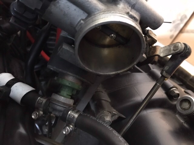

Guzzimax Posted May 8, 2021 Author Posted May 8, 2021 Took the air filters off today, cleaned the inside of the throttle bodies with carb cleaner, the valves are moving fine, there’s nothing obstructing the linkage in the “tunnel” and the cold start is operating OK without any obstruction. Started the bike, problem still there, revs immediately to around 4000 rpm, and continues climbing higher before I hit the kill button, so I must admit this has got me completely stymied
docc Posted May 8, 2021 Posted May 8, 2021 Have you done the test for an air leak between the throttle bodies and head?
Guzzimax Posted May 8, 2021 Author Posted May 8, 2021 Tried that, there’s no leaks on the intake side of the throttle bodies, the intake rubber hoses are new and have been clamped up correctly on the alloy intake pipes 1
docc Posted May 8, 2021 Posted May 8, 2021 Possibly a sensor unplugged ? (Not sure which, if any, would trigger uncontrolled rpm . . .)
Lucky Phil Posted May 8, 2021 Posted May 8, 2021 Have you checked the fast idle cam is clear of the throttle mechanism? Ciao
Lucky Phil Posted May 8, 2021 Posted May 8, 2021 19 minutes ago, Guzzimax said: I’ll recheck the fast idle cam tomorrow How did you remove the throttle bodies, separate them from cross over supports and remove individually? Ciao 1
Guzzimax Posted May 8, 2021 Author Posted May 8, 2021 No, I didn’t remove them from the cross over support, I left them attached to that, I removed and replaced each rubber intake hose once I’d removed the cross over assembly by releasing the intake hose clamps 1
Lucky Phil Posted May 8, 2021 Posted May 8, 2021 14 minutes ago, Guzzimax said: No, I didn’t remove them from the cross over support, I left them attached to that, I removed and replaced each rubber intake hose once I’d removed the cross over assembly by releasing the intake hose clamps Ok so you didn't remove the throttle bodies from the bike, just the engine? Ciao
docc Posted May 8, 2021 Posted May 8, 2021 I recall removing my throttle body assembly on the RedFrame Sport required the frame to be "crabbed." This Guzzimax puzzle is a head-scratcher!
Lucky Phil Posted May 9, 2021 Posted May 9, 2021 I'd wind out the l/h TB idle screw until it has clearance ( the r/h should be clear already if one is indeed fitted) then disconnect the linkage and make sure both throttle plates are bottoming out inside the throttle bodies. You should adjust the linkage so when both throttle plates are bottomed in the bodies the small post on the end of the linkage aligns perfectly with the bush on the l/h linkage, then refit it. Wind the idle stop screw on the l/h side until it just touches the linkage and give it half a turn. This will guarantee the throttles are closing and then do a balance and idle adjustment. When you start it up it wont idle but you can adjust the idle stop screw until it does and you're in the ball park. Check the fast idle cam first. Ciao 1
