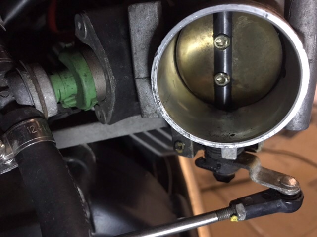

Tinknocker Posted May 9, 2021 Posted May 9, 2021 That last pic of the right t.b. doesn't look completely closed to me
Guzzimax Posted May 9, 2021 Author Posted May 9, 2021 Ticknocker, your observation is correct. Looking at this again today, both the left and right t.b butterfly valves are not completely closed. There is a small gap between the butterfly blade and the t.b. even when the throttle is fully closed. It’s not a big gap but it’s there. Whilst idling should the t.b valves be totally closed? If they should do I do this by adjusting the link rod that couples the t.b’s together? Is the white knob by the LH t.b the idle adjustment control?

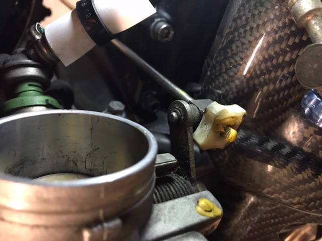

docc Posted May 9, 2021 Posted May 9, 2021 Sooooo - pretty sure the plates should be open enough to idle (not locked completely shut). The white knob is not the idle adjustment (it is the balancing adjustment between the throttle bodies). In your second image, above, (the one turned on its side), the glob of yellow paint fills the hex that is the right side idle stop screw. Looks like it could use some attention (like it's never been adjusted . . .) You, Sir, need a "Decent Tune-up" . . .
