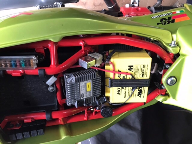

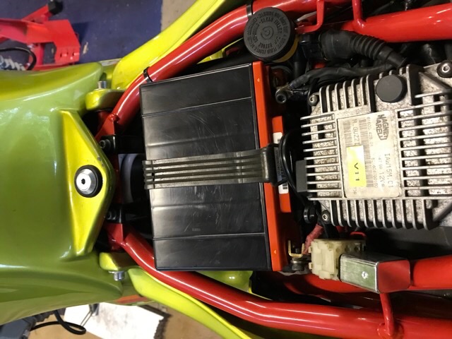

Guzzimax Posted May 8, 2021 Posted May 8, 2021 Just dropped an Odyssey PC545 into my 1999 Greenie, as has been said before they are an identical size to the Spark 500, a perfect “snug” fit 2
docc Posted May 8, 2021 Posted May 8, 2021 Looks like your seat pan is sitting a bit hard on your battery, @Guzzimax. I had to round a sharp corner on mine to save the battery strap. Also, the front of the battery basket can be mounted under the subframe to make clearance.

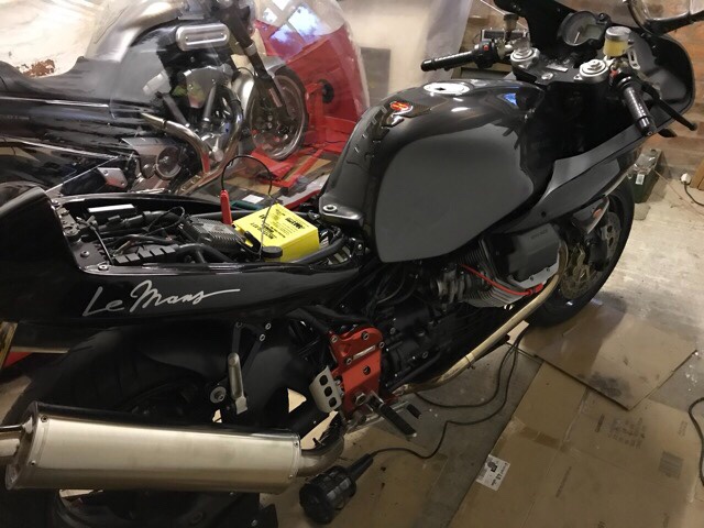

Guzzimax Posted May 8, 2021 Posted May 8, 2021 Until I decide to replace it with another Odyssey or a Yuasa AGM, the Motobatt has gone into my LeMans, it’s somewhat smaller that the Odyssey I’m not yet convinced to go down the Lithium route 1
Guzzimax Posted May 8, 2021 Posted May 8, 2021 Thanks for the advice docc, I think that’s because I’ve just changed out the Motobatt for the Odessey and the Motobatt is slightly deeper so the seat was contacting the battery strap. I’ll take the Motobatt out of the LeMans when it gets back in the road and find a replacement. You can see the Motobatt is narrower than the Odessey. Good point about lowering the battery cage 1

bsanorton Posted May 21, 2021 Posted May 21, 2021 On 5/8/2021 at 4:57 PM, docc said: Looks like your seat pan is sitting a bit hard on your battery, @Guzzimax. I had to round a sharp corner on mine to save the battery strap. Also, the front of the battery basket can be mounted under the subframe to make clearance. Hey Doc, how much do you gain by that, about 1/4 inch? Can you add spacers to lower even more? After your observation I checked my strap and sure enough it's wearing by the front
