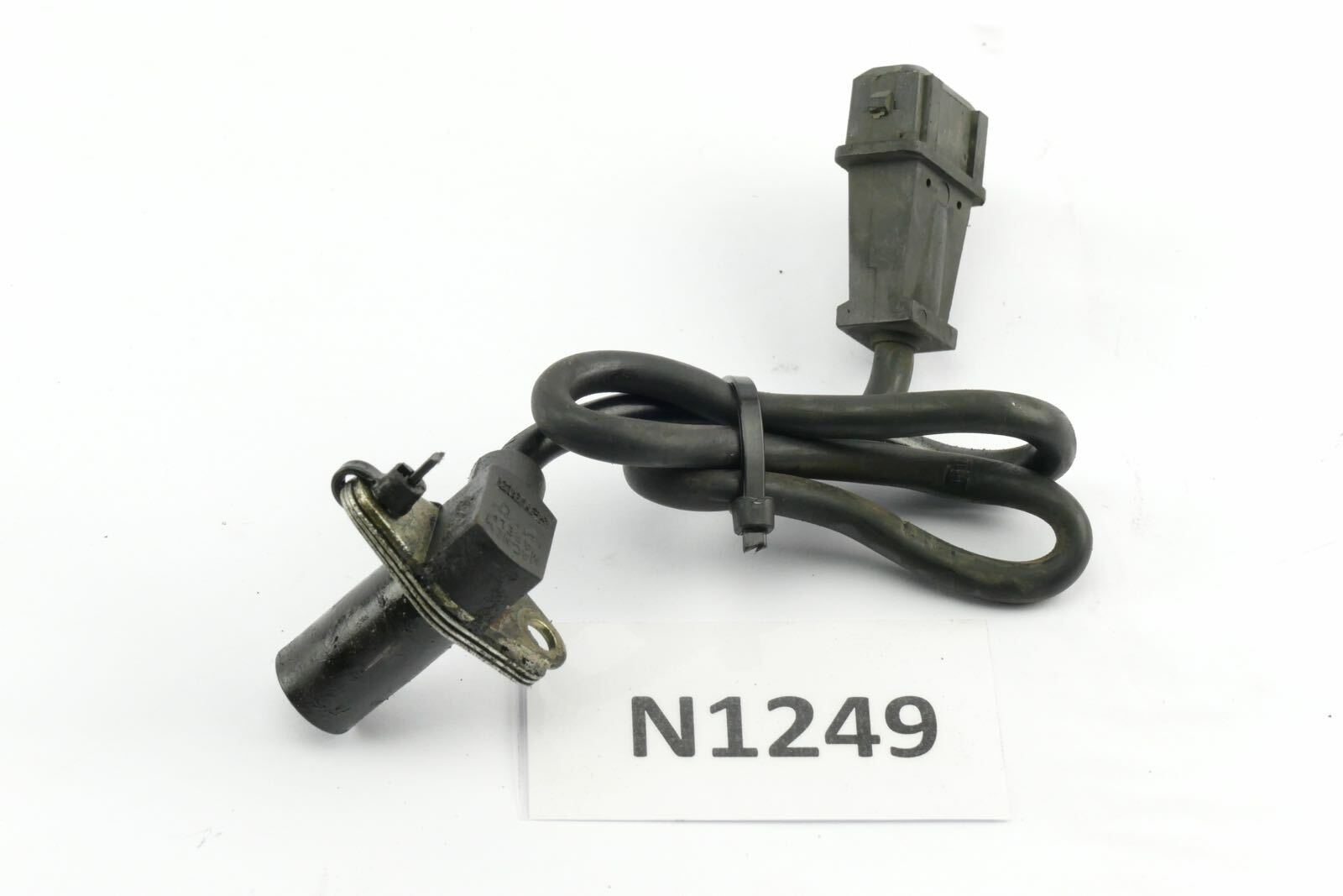

jetboy Posted May 27, 2021 Author Share Posted May 27, 2021 its not SUPER new. 3 years? there were a lot of dragon flies. still- that should not have those symptoms. I'll clean it out anyway as soon as the guy gets back and I can borrow some more tools. Meanwhile, I think I may have found it. the timing sensor cable must have been too close to the engine, the rubber has two burn marks in it, making divots. I don't see any wires but it could have been enough to fry them. I may take it out and see if I can repair it. any harm in just pulling that sensor side with the hex bolts? or do I have to do a thing before I do that? may totally not be the problem, but it looks suspicious. hopefully someone in town is better at soldering than me (also I have no tools for that one) 2 Link to comment Share on other sites More sharing options...
jetboy Posted May 27, 2021 Author Share Posted May 27, 2021 seems not so uncommon: looked on ebay and see the same damage (but mine is much deeper) on that one for sale. https://i.ebayimg.com/images/g/QbQAAOSwR8hdyz03/s-l1600.jpg Link to comment Share on other sites More sharing options...
Scud Posted May 27, 2021 Share Posted May 27, 2021 You can remove the sensor if you think the wires are damaged. Just be careful on re-install that you have the correct spacers. There could be none, or 3 spacers, or who knows... whatever. Just put it back exactly how it was. They are very sensitive and need an exact gap to run properly. FYI, I do have a spare ECU and possibly other stuff, that I could post tomorrow if you have a need (and I agree that needing and ECU seems very unlikely.) 1 Link to comment Share on other sites More sharing options...

MartyNZ Posted May 27, 2021 Share Posted May 27, 2021 Shimming V11 RPM Sensor.pdf On 5/27/2021 at 12:23 PM, jetboy said: ...Suddenly loses a power for a second, then does again.. gets worse and worse until it totally cuts out... Josh, I suspect that your phase/revolution sensor PN GU01721600 is bad. It is a coil of very fine wire inside a resin body. It can work ok when cold, but become open circuit as the engine warms up. If the connection in the coil wire is intermittent, then the engine will be erratic. See links below to previous posts including an alternate non-Guzzi part source, and gap setting instruction attached. phase sensor repair - How to... - Moto Guzzi V11LeMans.com Forum https://www.v11lemans.com/forums/index.php?/topic/19509-v11-sneeze/&tab=comments#elControls_211454_menu Timing sensor Leak - Technical Topics - Moto Guzzi V11LeMans.com Forum 2 Link to comment Share on other sites More sharing options...
R.I.P. Mikko Posted May 27, 2021 Share Posted May 27, 2021 Did anyone suggest the side stand switch? Bypass that.. If you do suspect bad fuel, try using Heet instead of seafoam. Maybe a can of octane booster if that’s available there. 1 Link to comment Share on other sites More sharing options...
Chuck Posted May 27, 2021 Share Posted May 27, 2021 My bet is on the phase sensor, too. It certainly can't hurt to put fresh gas in it, though, although didn't you have this problem before the trip? 3 Link to comment Share on other sites More sharing options...
fotoguzzi Posted May 27, 2021 Share Posted May 27, 2021 I agree with Chuck. That sensor wire makes a sharp angle when mounted sometimes and can break or stress the wiring inside, can get worse when engine is hot as the wire shielding can get soft. 2 Link to comment Share on other sites More sharing options...
