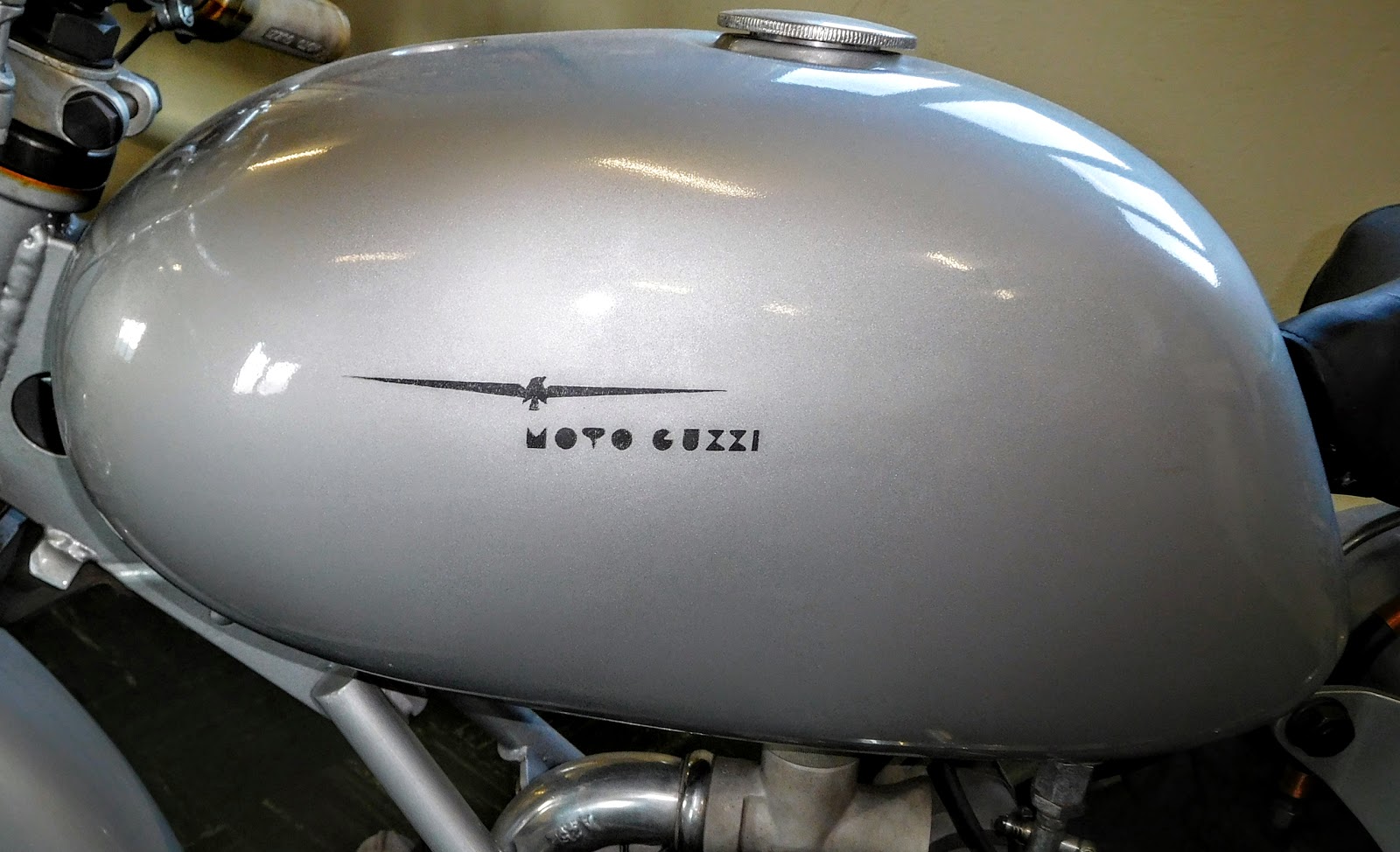

footgoose Posted May 28, 2021 Posted May 28, 2021 If I could get a replica aluminum tank like this one for under $2k I'd do it. I personally wouldn't like a tank under a false cover on the V11. The next route for me would be a standard tank dried out and sealed internally. It should not expand or bubble after that and any fitment problem that may still exist, make adjustments to the frame mounts. 2
docc Posted May 28, 2021 Posted May 28, 2021 ooooh, I know how I would badge that tank . . . only in blue . . . 2
Grim Posted May 28, 2021 Author Posted May 28, 2021 54 minutes ago, footgoose said: I personally wouldn't like a tank under a false cover on the V11. Yeah a full ally tank would be the holy grail, there are a few places in the UK, I've called/emailed alot of them and they either don't want to do it or it would be prohibitively expensive, or they don't answer. What are your reasons for disliking a false cover? Just personal preference or do you foresee some V11 specific problem? I have looked at sealing, too many horror stories of it coming off and going into the fuel lines. Some folks were adamant that the nylon of the V11 tank was to slippery for a seal to get a good hold on, even when agitated with nails etc Perhaps if a garage did it and would guarantee the seal? .
footgoose Posted May 28, 2021 Posted May 28, 2021 yeah just personal preference. No functional problems. I guess I don't like esthetic "covers" in general. Though it would certainly solve the problem. I'm lucky with my tanks I don't need to pursue the sealant route to find out. I'd certainly have to feel good about the process before doing it. I don't recall seeing any bubbling on early tanks, only later ones. Anybody out there have bubble experience? This also has me thinking about the process of mfg of these tanks. Why some bubble, some not. Thickness of material throughout can't be consistent.
footgoose Posted May 28, 2021 Posted May 28, 2021 1 hour ago, docc said: ooooh, I know how I would badge that tank . . . only in blue . . . Just buy one and get it over with Docc 1
docc Posted May 28, 2021 Posted May 28, 2021 7 minutes ago, footgoose said: Just buy one and get it over with Docc If I could have just one other Moto Guzzi . . . I've seen very few early V11 tanks bubble their paint, and that is usually low on the "panniers" where the moisture would accumulate the most. The worst have been those V11 with extensive "decals" clearcoated onto the tank paint (Rosso and Nero Corsa). I'm not sure what those decals are (polyehtylene sheet?), but they certainly trap any outgassing that might otherwise work its way out of the tank material and its paint. 1
Rox Lemans Posted May 29, 2021 Posted May 29, 2021 2 hours ago, footgoose said: If I could get a replica aluminum tank like this one for under $2k I'd do it. I personally wouldn't like a tank under a false cover on the V11. The next route for me would be a standard tank dried out and sealed internally. It should not expand or bubble after that and any fitment problem that may still exist, make adjustments to the frame mounts. I know Tankshop in the UK used to do these tanks years ago for external fuel pump bikes. Worth a shot. They were pricy however hand made. Worth a shot to see if they're still banging out tanks. 2 1
