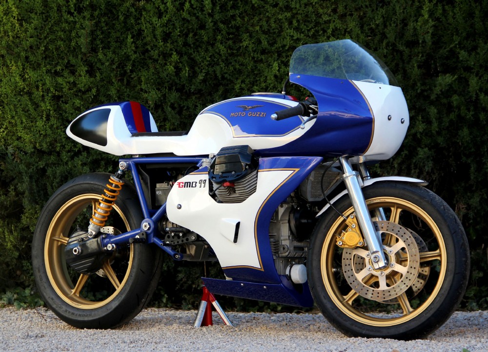

Pressureangle Posted July 10, 2021 Posted July 10, 2021 This is actually in Marvic's gallery. Appear to be 18" but it does look effective. 3
