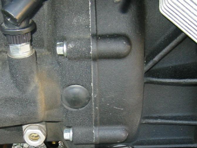

Guest IanJ Posted March 21, 2004 Posted March 21, 2004 Woot! My Le Mans came home on Friday night (sooner than expected). Final balancing cost was $250, and it appears that the machine shop actually wanted to spend more than that, but I'd left written instructions that $250 was the limit. The engine runs just fine, although the idle speed needs to be adjusted. I had a small oil weep coming from the crankshaft pulse sensor, which was easily fixed, and otherwise no problems. The paint tone is slightly different from that of the transmission and oil pan. I can best describe it as being "smoother" and "darker". I'll post pictures later today. It's not really different enough that you look at it and immediately notice it, but if you look at all closely, it's apparent. I can't tell if the difference is because MG messed up the paint formula, or because of the age difference between the areas.
Guest IanJ Posted March 22, 2004 Posted March 22, 2004 Here is a picture of the intersection between the engine and transmission on my transplanted engine case.
al_roethlisberger Posted March 22, 2004 Posted March 22, 2004 That's not too bad It looks very similar to the picture posted last Fall by someone?? that had the cases swapped, so it looks like this is the finish they are going with. al
