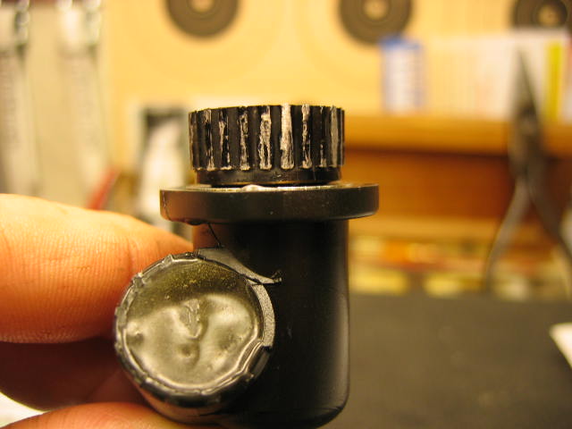

Stinkywheels Posted August 20, 2021 Author Posted August 20, 2021 8 minutes ago, p6x said: If you peruse the forum, you will find a few threads discussing this sorry issue. Just above, I posted a link to a US based Veglia/ITI instruments' wizard. For you, since both speedo and odo are not working, it may be the angle drive. People with better experience in these matters will chime in I am sure. Since the angle drive was screwed anyway, I took it apart. Very crappy gears, output gear was cracked, input had lots of casting flash. I have a friend that is a jeweler and has experience casting intricate fiddly stuff. If it was possible to get these drives apart gracefully and hand finish and lube them, they might last longer. 1
docc Posted August 20, 2021 Posted August 20, 2021 That would be amazing that someone could build durable parts for those angle drives. Here is one of many threads about the angle drives, although I don’t think it includes an image of epoxying the end plug.
docc Posted August 20, 2021 Posted August 20, 2021 Okay, here is an image of the metal disc plug JBWelded in. They are bad about leaving the party without asking. And taking your one-and-only internal drive gear with it . . . 1
docc Posted August 20, 2021 Posted August 20, 2021 That last image is in this thread where it is noted that the housing tends to walk off the brass insert that anchors it to the gearbox. They can be easily pressed back together in a vice. One more contributor to the speedometer needle's St. Vitus Dance . . .
