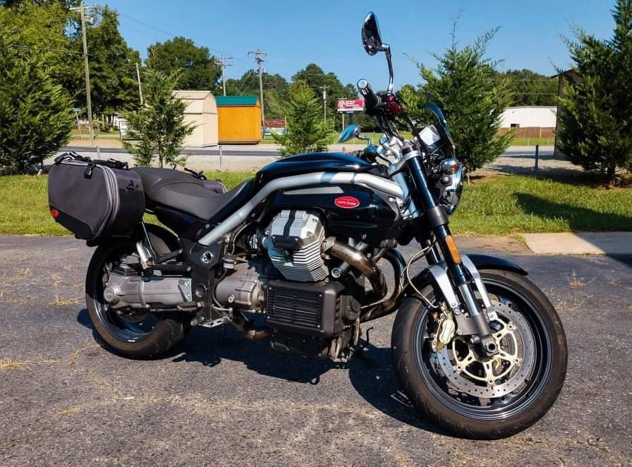

Bbennett Posted August 23, 2021 Posted August 23, 2021 Nice bike. I've thought about getting one too but it seemed frustratingly redundant with my V11 Sport. Those panniers look sharp. 2
Randy Posted August 23, 2021 Author Posted August 23, 2021 On 8/23/2021 at 5:20 PM, docc said: Sweet! Comes with a story? Expand Sort of. Owner bought it a couple of months ago but could not sort out missing and stumbling at idle and mid-range. Literally priced at a point that I couldn't pass it up. Idle was all over the place and it popped and banged like the 4th of July. Started with carb balance and TPS reset, helped until it warmed up and the party resumed. Upped the CO setting, helped short term but still returned. Valves were a little wide but not much. Finally tried Reset Learning Parameters and she settled down and purred like a kitten (or a tractor). Evidently someone wrote a new map to it and forgot to reset this so it was following its old settings. Now I've got to go back and tweak the CO setting because I think I've probably got it too rich. 3 1
Randy Posted August 23, 2021 Author Posted August 23, 2021 On 8/23/2021 at 6:08 PM, Cabernet said: Ooh! That's CARC. Expand My first single swingarm bike.

pete roper Posted August 23, 2021 Posted August 23, 2021 Swingarm bearings and shock linkage bearings will need attention. Enjoy. 2 1
docc Posted August 23, 2021 Posted August 23, 2021 On 8/23/2021 at 7:45 PM, Randy said: Sort of. Owner bought it a couple of months ago but could not sort out missing and stumbling at idle and mid-range. Literally priced at a point that I couldn't pass it up. Idle was all over the place and it popped and banged like the 4th of July. Started with carb balance and TPS reset, helped until it warmed up and the party resumed. Upped the CO setting, helped short term but still returned. Valves were a little wide but not much. Finally tried Reset Learning Parameters and she settled down and purred like a kitten (or a tractor). Evidently someone wrote a new map to it and forgot to reset this so it was following its old settings. Now I've got to go back and tweak the CO setting because I think I've probably got it too rich. Expand There is the matter of the Sacred (idle stop) Screw serving an indexing function in this system as opposed to the V11's which is used for "idle adjustment." That the ECU can "relearn parameters" is based upon that index screw being set to the correct throttle plate angle. If some hairy-arsed knuckle dragger (it wasn't me this time, @pete roper !) arsed with the stop screw, it must correctly be located again for the map to index properly to the throttle openings. You have guzzidiag, @Randy ? 1

Randy Posted August 24, 2021 Author Posted August 24, 2021 On 8/23/2021 at 10:44 PM, docc said: There is the matter of the Sacred (idle stop) Screw serving an indexing function in this system as opposed to the V11's which is used for "idle adjustment." That the ECU can "relearn parameters" is based upon that index screw being set to the correct throttle plate angle. If some hairy-arsed knuckle dragger (it wasn't me this time, @pete roper !) arsed with the stop screw, it must correctly be located again for the map to index properly to the throttle openings. You have guzzidiag, @Randy ? Expand Sacred screw still had paint on it and had not been disturbed. Guzzidiag. 1
Randy Posted August 24, 2021 Author Posted August 24, 2021 On 8/23/2021 at 9:03 PM, pete roper said: Swingarm bearings and shock linkage bearings will need attention. Enjoy. Expand And that piece of crap rear shock. Anyone have a Stelvio shock around they want to get rid of?
Randy Posted August 24, 2021 Author Posted August 24, 2021 On 8/24/2021 at 2:49 AM, Rox Lemans said: Man, Grisos are just sexy. Expand Big jugs, big pipes and an off the shoulder oil cooler, what else could you want? 1 1
