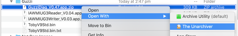

TobyBott Posted September 5, 2021 Posted September 5, 2021 Hi p6x I had the same error trying to open GuzziDiag on my Mac after downloading. Try unzipping the file with The unarchiver instead of Archive Utility. Then open the unzipped app with right click/Open It worked for me on Catalina. 2
p6x Posted September 8, 2021 Author Posted September 8, 2021 Thank you very much Toby.... To "ping" me, you have to use the @sign, and then @TobyBott my name when it appears. Then I get notified that someone has answered the topic. This is very good news, because my attempts to make contact with the TuneECU people yielded nothing. Nobody answered the question on the Forum supposedly managed by the software developer; and on their FB page, I received a lot of compliments about the Le Mans, but not a single confirmation that TuneECU could be used with it. ....
p6x Posted September 8, 2021 Author Posted September 8, 2021 @TobyBott It worked as you described it, if excepted that on my first attempt to run the application, MacOS refused and displayed a message the application could not be verified for malware because downloaded from outside of the store. The only two options shown to me were: move to trash or close... I closed, and attempted to reopen and then it worked. I am taking this as an attempt from Apple to prevent me from infecting my computer, sort of a warning. The program settings only offer V11 Le Mans 2002; I suppose it works for the Le Mans 2004? IAW 15M PF3C?
