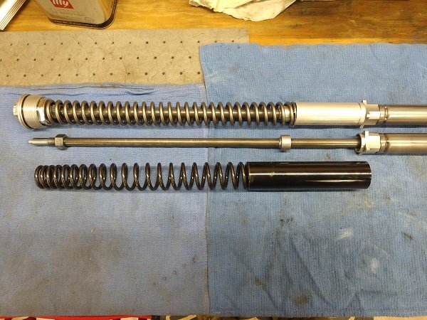

BillyB Posted November 1, 2021 Author Posted November 1, 2021 Quick update - after I ordered the .90 springs from Race Tech, I found somewhere online saying the stock springs are .86, so the .90 didn't seem like enough of a difference so I shipped those back and ordered .95s. This took longer than expected (Race Tech lost the springs I sent back and took 2 weeks to find them). Anyways they sent the .95s and I went to fit them last week and they won't work. They're a lot longer than the stock springs and the travel stop on the damper rod was hanging up on the junction between the spring and spacer. I just called Race Tech back and they don't know who suggested the springs I bought, but confirmed that the correct spring for this Marzocchi 43mm fork is their S3827 series spring. They're shipping those out today. I realize this was a terrible explanation of the issue but hopefully the picture helps. On the bottom is the stock spring/spacer, and installed on the top damping unit is the (wrong) Race Tech spring/spacer. You can see how that little collar on the damping rod will be hanging up on the inside of the spring/washer/spacer, especially since the spring they sent is smaller in OD than the stock one and has room to move around inside the fork tube. The new spring they're sending is a larger OD, similar to the stock spring. In the meantime I got a new MShock mounted up in the back so I'm looking forward to getting the front end together again finally, just in time for winter to set in! 1
nobleswood Posted November 3, 2021 Posted November 3, 2021 BillyB from my experience with Ohlins, Racetech & Traxxion in that order. Some companies have a lot bigger clients & accounts to deal with & they aren’t going to make much $ from our modest purchases. Hence the service you receive can vary from which technician you get on the phone, so if you find a knowledgeable & helpful tech, write his number down & share it with us So for those following in your footsteps that Racetech spring number helps & saves others from techs not paying as much time as they should. 👍 2
