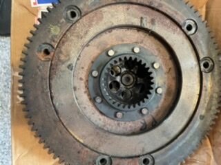

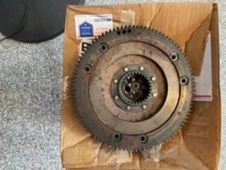

footgoose Posted September 15, 2021 Posted September 15, 2021 4 hours ago, fotoguzzi said: For reference, here is the Scurra FW Did you remove this? were the crank bolts snug? 1
PJPR01 Posted September 15, 2021 Posted September 15, 2021 Hi Chuck, Took some pictures this morning…this is what I have available. Mike had replaced it with a single plate California steel clutch assembly, was particularly hard to find…but he was able to locate one. 2
