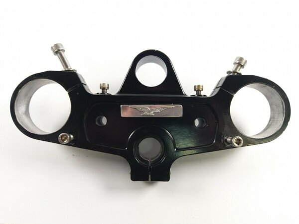

Lucky Phil Posted December 2, 2021 Posted December 2, 2021 1 hour ago, docc said: Yes, all V11 after about January 2000 have the same geometry. The part numbers are cast into the bottoms of the triples. They are hard to see. That “Geometry” thread I linked above has the details on the part numbers. Also, there is a post showing @footgoose’s January 2000 Sport that has the early triples, while my March 2000 has the later parts. (Not that Guzzi is known to make changes at a specific date or point in production.) I just re read that whole thread docc and at the end of the day there seems to be no conclusive evidence that the clamps were changed apart from some numbers which at the time I couldn't identify on my bike. I'll have another look today. I only ask as I want to fit the later top clamp to my bike. I'd be surprised if Guzzi actually went to the trouble of producing a set of triple clamps with fork bores not aligned with the steering stem axis to the tune of 1/2 degree. I've had bikes with this set up from the factory ( My RC30 Honda had it from memory) but it's a bit unusual esp as an afterthought attempt to solve a handling issue. You generally change the offset to correct a problem. My 1198 has Dan Kyle 30mm offset triple clamps as opposed to the std 36mm offset to improve the steering. If anyone has a set of the later clamps or even the upper clamp like shown below I'd be interested. I can also then do a forensic measurement and put this to bed once and for all, maybe:) Same as this but without the holes open holes. Ciao
docc Posted December 2, 2021 Posted December 2, 2021 Apparently, there was an early service bulletin on the early V11 Sport triple tree issue, but no one has ever produced it for us. It was Greg field that initially brought this to our attention. I put a lot of credence into his insights. He was in a unique position at Moto International, Seattle WA/USA, to have access to source documents and actual service experiences. From our observations at that SpineRaid, it appears the early triples were leftover from the 1100 Sport-i and that the change was. indeed, an attempt to correct a problem (early reports of instability of the RedFrame).

Lucky Phil Posted December 4, 2021 Posted December 4, 2021 On 12/3/2021 at 10:30 AM, docc said: Apparently, there was an early service bulletin on the early V11 Sport triple tree issue, but no one has ever produced it for us. It was Greg field that initially brought this to our attention. I put a lot of credence into his insights. He was in a unique position at Moto International, Seattle WA/USA, to have access to source documents and actual service experiences. From our observations at that SpineRaid, it appears the early triples were leftover from the 1100 Sport-i and that the change was. indeed, an attempt to correct a problem (early reports of instability of the RedFrame). Gregs info was also that basically any early bike with an axle nut had the old steeper triple clamps. My bike has the later 501452 top clamp ( very hard to find number as its up next to the ignition switch) so either Gregs wrong OR my bike has updated triple clamps with the old style forks? Not sure. If I pull them off I can measure them on the surface plate. Ciao 1
docc Posted December 4, 2021 Posted December 4, 2021 1 minute ago, Lucky Phil said: Gregs info was also that basically any early bike with an axle nut had the old steeper triple clamps. My bike has the later 501452 top clamp ( very hard to find number as its up next to the ignition switch) so either Gregs wrong OR my bike has updated triple clamps with the old style forks? Not sure. If I pull them off I can measure them on the surface plate. Ciao Hmm, wait . . . I thought he said a nutted axle (like mine) has the later (canted?) triples. Earlier screw-in axles "might" have the questionable (carry-over?) triples?
Lucky Phil Posted December 4, 2021 Posted December 4, 2021 2 hours ago, docc said: Hmm, wait . . . I thought he said a nutted axle (like mine) has the later (canted?) triples. Earlier screw-in axles "might" have the questionable (carry-over?) triples? Greg Field quote from earlier post. Guzzimoto: You are understanding me correctly. The later triple clamps include a 1/2-degree of cant compared to the steering axis. These gray "canted" triple clamps were used through the end of the red-frames. In general, if your red-frame's forks have an axle nut, they also have the early non-"canted" clamps and if your red-frame has an axle that screws directly into the fork leg, it has the "canted" clamps. There is some crossover between axle-fixing arrangements and clamps, though, and Guzzi offered a kit of the "canted" clamps for people who wanted to reduce twitchiness of their early bikes, so any combination of parts is possible. Rosso Mandellos had black "canted" triple clamps. Starting with the LeMans, Guzzi again fitted non-"canted" clamps, but they were painted black. Still not definitive. I have see a "kit" from Guzzi with a pair of clamps but not sure of their dimensions. Note the "kit". Not sure if it means anything. https://www.stein-dinse.biz/product_info.php?language=en&products_id=60733 Ciao 1
