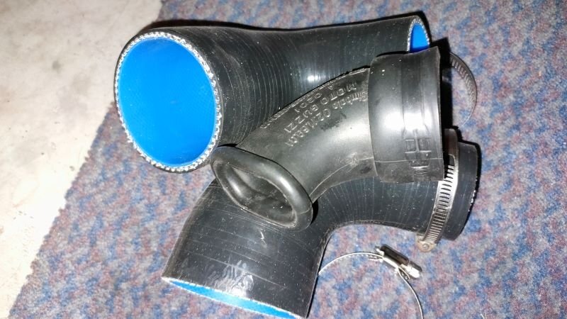

I'm going to experiment with 45-63mm reducing silicon rubber elbows. 63 is too big to fit in there but may work after trimming to fit. I like the idea of long induction pipes to help collect cool air ahead of the engine. A downward bend should reduce the road spray, grit, and bumblebees getting to the filter.
