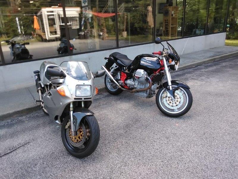

docc Posted December 30, 2021 Posted December 30, 2021 11 minutes ago, VtwinStorm said: Pretty sure my mirrors aren't stock. I have never seen them in any factory photos of a V11...No idea what they are from. IDK, bud. These look like the stockers ("stalkers?!?" ) to me . . . Reference images: 1
VtwinStorm Posted December 30, 2021 Author Posted December 30, 2021 27 minutes ago, docc said: IDK, bud. These look like the stockers ("stalkers?!?" ) to me . . . Reference images: Hmmm...they really photograph differently. Mine aren't matte finish...but very glossy, almost wet looking. Also, not so rounded, but pointy. I'm just imagining things I guess. Anyway, stock mirrors work great for me. Just need to iron out the vibration in the hand grips.
docc Posted December 30, 2021 Posted December 30, 2021 9 minutes ago, VtwinStorm said: Hmmm...they really photograph differently. Mine aren't matte finish...but very glossy, almost wet looking. Also, not so rounded, but pointy. I'm just imagining things I guess. Anyway, stock mirrors work great for me. Just need to iron out the vibration in the hand grips. Yep, I see the difference with your glossy mirrors. Just saying they might be amplifying the vibration. And harshness. Noise? That could just be me . . . 1
VtwinStorm Posted December 30, 2021 Author Posted December 30, 2021 3 hours ago, docc said: Yep, I see the difference with your glossy mirrors. Just saying they might be amplifying the vibration. And harshness. Noise? That could just be me . . . No strange noise... machine sounded great before her major service. Perhaps I should get a set of Napoleon bar end mirrors after all...
