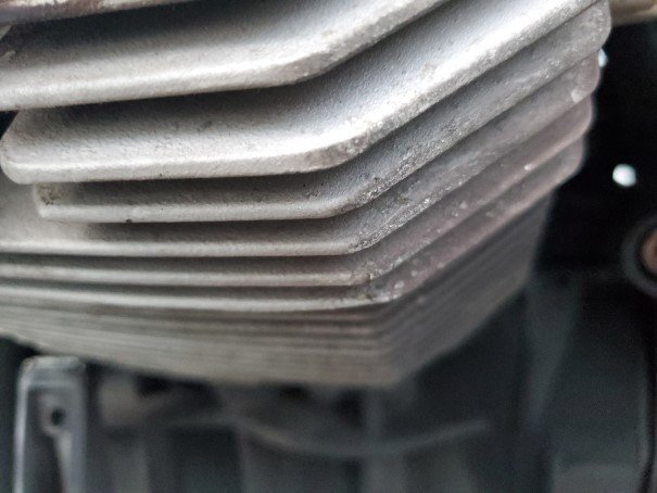

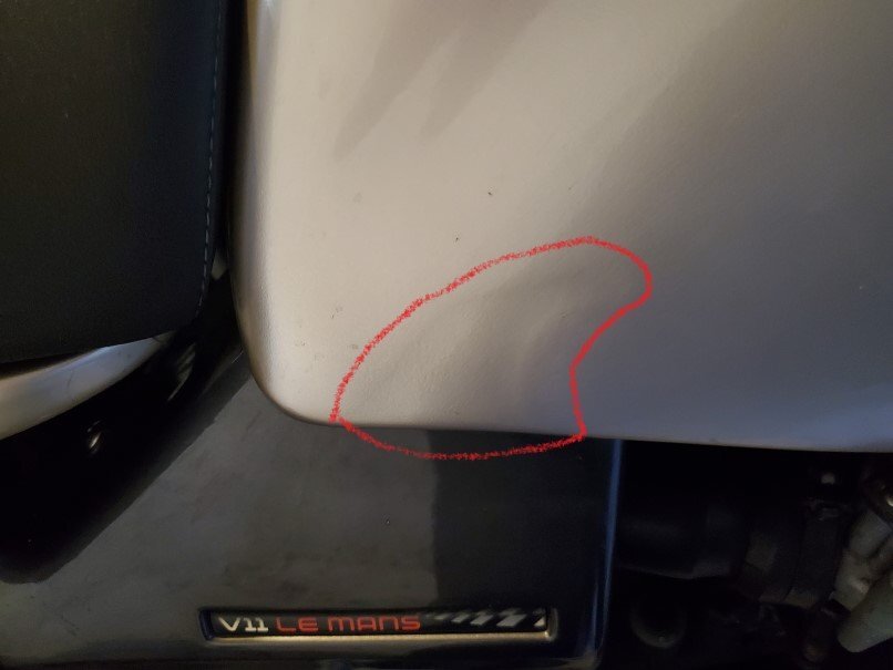

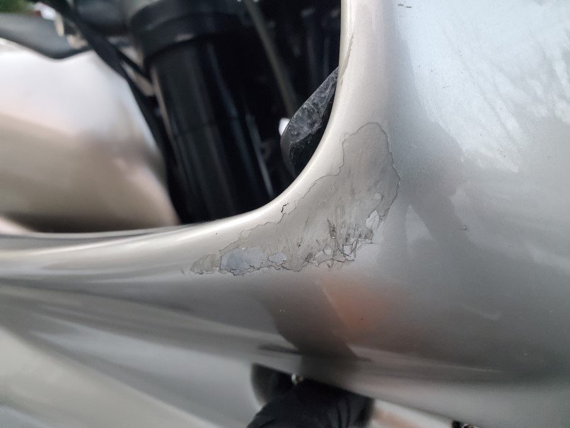

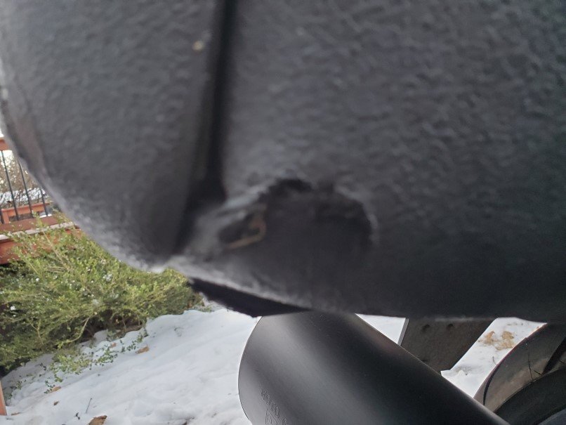

FreyZI Posted January 23, 2022 Posted January 23, 2022 Yesterday I brough home the champagne '02 Lemans of former forum member twhitaker (RIP). This was a bit of a Covid Times purchase, I think: something to do, not particularly well thought out or investigated, just scratching a wild hair. Well, at least I didn't resign my job. Pros: I do actually like the color. I was afraid it was going to be too close to simlar vintage Toyota Camry old-lady beige. It isn't. Maybe more Iron Man gold. It's tasteful, yet not absolutely boring. When the snow clears, I'll get a sid-by-side photo of the Tenni and the champagne (I laid a couple stone of salt to clear a narrow path from garage - it's not great motorcycling weather in this neck of the woods). It's a Motto Guzzi V11! Started up in single digit temperature; sounded okay PO has ridden -- fast! (how fast will remain undisclosed) Cons: Cosmetic damage (mostly what I know at present -- this bike has 44K miles on the clock and it looks like it did every bit of it). This bike went down on its right side at some point. It buggered up the cylinder head guard -- which did its job rather well Damaged right fairing Bar end was replaced with something dramatically different in size (and presumably mass) Hard cases dented, abraided, and small tears Mufflers mismatched (one painted to be less obviously mismatched) Front wheel rim gouged Front fender abraided Right mirror cup abraided Rear hugger abraided Seat okay but not great Seat cowl scratched Some fuel tank anomoly and also rubbing from throttle friction device when bars at full right lock Some corrosion on fins, master cylinder cover, elsewhere Pork chops' anodized finish peeling badly and otherwise beat up Cylinder head finish bubling Engine case paint isn't perfect, but doesn't seem too bad (I'd welcome a pic of what bad looks like) Basically, bike is pretty filthy Mechanical problems Neutral light intermittent failure with concomitant sidestand-triggered engine cut-off, even in neutral judging from presence of oil on final drive outer case, possibly a bad seal Feels like steering lock doesn't engage quite soon enough Oily grime about intake at R cylinder (maybe L, too -- haven't looked that closely) Odometer 60 degree bit held together with a grocery twist tie Notable features Highway pegs (Looking forward to trying these, but worried these are actally designed to melt boots) More to come. Thanks in advance for helping with the trouble shooting! Cheers, Frey 2
FreyZI Posted January 23, 2022 Author Posted January 23, 2022 So, one of the things I must consider is what to do with this bike: 1) make sure mechanicals are good and store it for when/if something goes wrong with the Tenni. 2) rehabilitate it mechanically, but leave it alone cosmetically and have that rat bike I've always wanted. 3) Spruce her up considerably and really appreciate (per Docc) the monochromatic fireball. Additional pics:

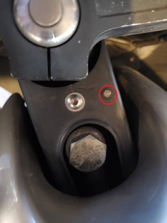

FreyZI Posted January 23, 2022 Author Posted January 23, 2022 What is this thing on the spine? The Tenni doesn't have it. I imagine it has something to do with the boobytrap (a la Mad Max in Bartertown). And here are the boot fryers: Anybody used them?

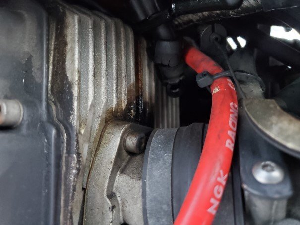

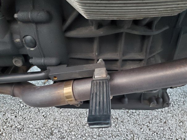

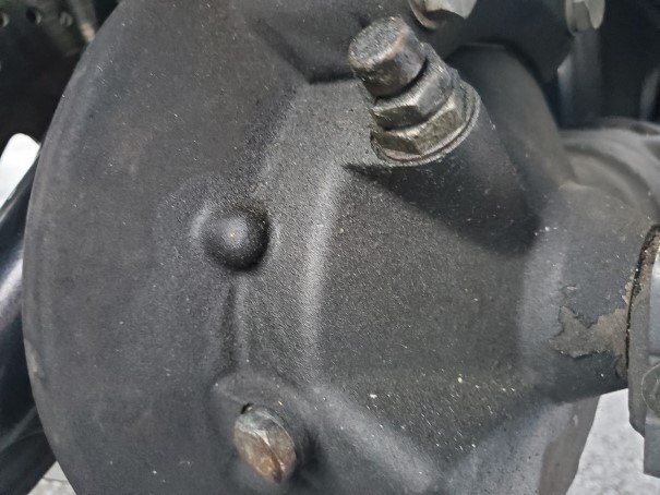

Scud Posted January 23, 2022 Posted January 23, 2022 That looks like a worthy project. If engine paint isn't bubbling now, it was probably redone by Moto Guzzi. The oil on the final drive is likely due to over-filling. From the pics, I'd guess the breather vent is the source of the mess. Those foot-forward, highway pegs? Wow. Personally, I'd remove those immediately. If you decide to freshen it up, I have a lot of stuff from a Champagne LeMans that I ended up stripping. The frame plates and rockers covers look fabulous in candy-apple red next to the champagne paint. If the fairing damage is more than you want to deal with, you could convert to a sport headlight with or without a flyscreen. 4

FreyZI Posted January 24, 2022 Author Posted January 24, 2022 4 hours ago, Scud said: If the fairing damage is more than you want to deal with, you could convert to a sport headlight with or without a flyscreen. It's not that bad.... I'd rather keep the fairing. But I'll PM you about parts. Cheers.
Scud Posted January 24, 2022 Posted January 24, 2022 Oh - that looks like only a paint problem. The fairing on mine had been ground flat in that spot, (but on left so maybe I have a good RH mirror). I sold the fairing to somebody who wanted to paint it to match a greenie.

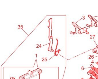

FreyZI Posted January 30, 2022 Author Posted January 30, 2022 Under the seat with some fuses and the tool kit, I found a bit of bubble wrap with a spring inside, subsequently identified as the spring (25) that attaches to the ratchet in the gear selector box. What do you make of that? It seems like it would be a bit of a complex roadside fix to replace that spring. Is that a weak spot? Does this suggest a past problem or portend failure?
deadpen69 Posted January 30, 2022 Posted January 30, 2022 Is it this spring? Gearbox Selector Spring & Pawl Arm repair
footgoose Posted January 30, 2022 Posted January 30, 2022 12 minutes ago, deadpen69 said: Is it this spring? Gearbox Selector Spring & Pawl Arm repair Yes that's spring that breaks. that thread gives some early forum history of the problem and contains a link to the roadside repair as well FreyZ1 ... if the spring under the seat has only one coil then it's another one to not be trusted. 2 coils and it's the new improved spring. Owners who had not yet replaced theirs, often carried an extra to ward off bad ju ju and have one handy in case of emergency need. 3
docc Posted January 30, 2022 Posted January 30, 2022 Ah, yes, an aware owner and a "talisman spring." The Real-Deal SuperSpring (accept no substitutes): 3 1
docc Posted January 30, 2022 Posted January 30, 2022 2 hours ago, deadpen69 said: Is it this spring? Gearbox Selector Spring & Pawl Arm repair Ah, @belfastguzzi gave us the earliest taste of just how bold we should be with the V11 shift plate . . . * not for the squeamish! * https://www.flickr.com/photos/belfastguzzi/sets/72157625688157804/
