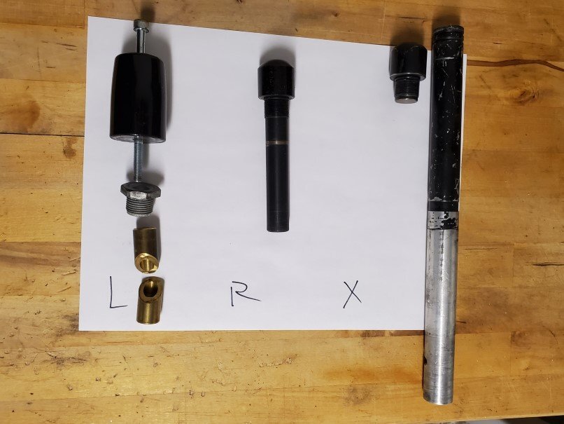

FreyZI Posted February 1, 2022 Author Posted February 1, 2022 Thanks for all the spring info. Onto the next thing: clip-ons. Took the weights off the left and right clip-ons; the third weight and clip-on were in the box. You can imagine how this bike looked with the protuberant appendage growing off (only) the left clip-on . The hollow bolt ("ring nut") with (L) seems to be a #3/4-16 (SAE???). The weight (R) seems to be an M18-1.0 which fits into the ~5-1/2" recess of the clip-on, which had been buggered up and new threads tapped. (X) is also apparently M18-1.0, matching the original threads of the clip-on (though that recess is only ~7/8") (sorry I'm not using metric). Doesn't look like any of this stuff is original equipment. I know there are one or more threads on handlebar weights I'll review.

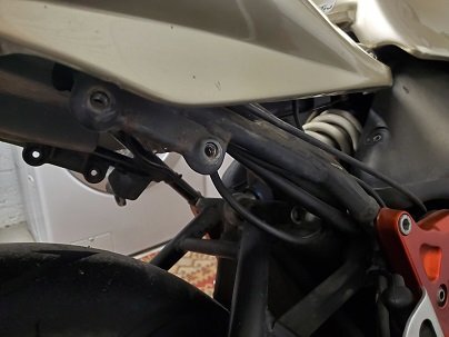

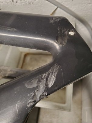

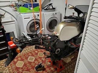

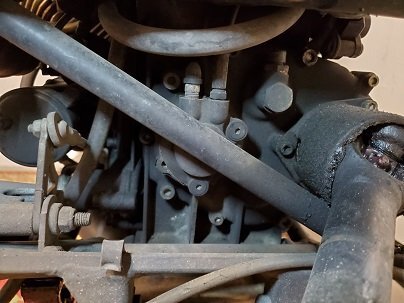

FreyZI Posted February 3, 2022 Author Posted February 3, 2022 Digging a little deeper into the champagne . With some Malbec. First, needed to find a little space to work. The garage is well above freezing, but not a lovely place to be, and not a lot of space in there with 4 motorcycles and my son's old dirt bike, and a snowblower. Thought to myself ... the laundry room. There's a space that gets used maybe a few minutes a week. It's small, but it's brighter and warmer. No bike lift and nothing to tie down to, so I put some eye hooks in the ceiling and ran a few cam straps for protection against a tip over. Raised and blocked, and the digging began. At first, I thought maybe I had some frame damage because of 1) gashes in the hugger, 2) considerable wear on the side cover from the tank and the rear subframe surround, and 3) that rear bolt for the passenger peg bracket was inaccessible because it was slightly overlapped by that surround. However, I wasn't able to find any frame damage, the damage to the hugger was probably caused by some of the tolerance being taken up by the Hepco & Becker rack mounting, looking at the Tenni, that rear passenger peg bracket couldn't come out, either, without removing the surround (seems a bit daft), and the side panels are not a great fit over the air chambers and some overlap and rubbing are probably to be expected. What is your experience the fit of the side panels? 1

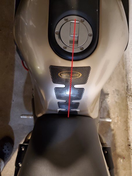

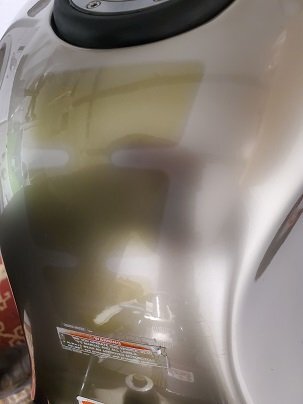

FreyZI Posted February 3, 2022 Author Posted February 3, 2022 Meanwhile, one thing that bothered me was that the tank grip was put on askew. Not so noticeable in this pic, but fairly obvious from some angles. Pad came off, but discoloration appears permanent. Guess I'll be looking for a slightly larger pad. Will start a new thread on pork chops. 1
Lucky Phil Posted February 3, 2022 Posted February 3, 2022 On 2/3/2022 at 4:48 AM, FreyZI said: Meanwhile, one thing that bothered me was that the tank grip was put on askew. Not so noticeable in this pic, but fairly obvious from some angles. Pad came off, but discoloration appears permanent. Guess I'll be looking for a slightly larger pad. Will start a new thread on pork chops. Expand I've been pointing this out for years to people. A fancy solid colour/carbon look tank scratch pad saves the scratches but then you have an issue with paint fade. So you need to buy a spare to replace it in time AND replace it perfectly aligned with the old one. Good luck with that. The best option? A clear scratch pad like I've always used. May look less sexy/trendy but a much smarter option. Make yourself a new solid pad thats slightly larger than the removed one that compensates for the off centre issue. Then you can have a centred pad that covers the fading paint. Ciao 1
Scud Posted February 3, 2022 Posted February 3, 2022 So first. I LOVE that this is happening in the laundry room. Answers and observations: Side panels usually fit well, but some can be a bit fiddly. They do tuck under the tank, so even if all the screws rattle out, they will not blow away while riding. The back of the tranny and subframe are quite a mess... have fun with that. And while you're at it, check that lower shock mount carefully. It looks like the original Sachs, which is prone to crack the lower mount. That hugger damage is common. My Nero Corsa came with a rear rack that used extra-long bolts and mangled the rear wheel hugger. This would be a good time to install one of those remote clutch bleeder hoses if you feel like spending $70. Otherwise, this is a good time to flush the clutch fluid while you can easily reach the bleeder. 4
PJPR01 Posted February 3, 2022 Posted February 3, 2022 Any thread that includes a reference to Malbec and motorcycles is worthy of a gold star! Quite creative way to setup an indoor workshop! 2

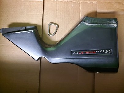

Lucky Phil Posted February 3, 2022 Posted February 3, 2022 On 2/3/2022 at 5:10 AM, Scud said: So first. I LOVE that this is happening in the laundry room. Answers and observations: Side panels usually fit well, but some can be a bit fiddly. They do tuck under the tank, so even if all the screws rattle out, they will not blow away while riding. The back of the tranny and subframe are quite a mess... have fun with that. And while you're at it, check that lower shock mount carefully. It looks like the original Sachs, which is prone to crack the lower mount. That hugger damage is common. My Nero Corsa came with a rear rack that used extra-long bolts and mangled the rear wheel hugger. This would be a good time to install one of those remote clutch bleeder hoses if you feel like spending $70. Otherwise, this is a good time to flush the clutch fluid while you can easily reach the bleeder. Expand I think it's a good idea to spacer up the rear tank mount to stop the tank rubbing the paint off the side covers. The covers are very prone to cracking around the mount holes and it's a material thats very hard to repair even with plastic welding. The solution is to elongate the holes nicely esp the top one which allows the cover to fit without stressing the thing. I can supply an image if you want to do it. Ciao 4 1
FreyZI Posted February 3, 2022 Author Posted February 3, 2022 On 2/3/2022 at 5:24 AM, Lucky Phil said: I think it's a good idea to spacer up the rear tank mount to stop the tank rubbing the paint off the side covers. The covers are very prone to cracking around the mount holes and it's a material thats very hard to repair even with plastic welding. The solution is to elongate the holes nicely esp the top one which allows the cover to fit without stressing the thing. I can supply an image if you want to do it. Expand That would be helpful. Thanks.

Lucky Phil Posted February 3, 2022 Posted February 3, 2022 On 2/3/2022 at 5:34 AM, FreyZI said: That would be helpful. Thanks. Expand The top mount in the image has been elongated quite a lot to relieve the cover of stress when affixed. Hard to understand how they got the placement so wrong. My bike has my own design and manufactured mount screws as well so the elongation isn't quite as obvious. You can but button head allow 5mm screws and do something similar. It's not noticeable when fitted if done accurately. Ciao
