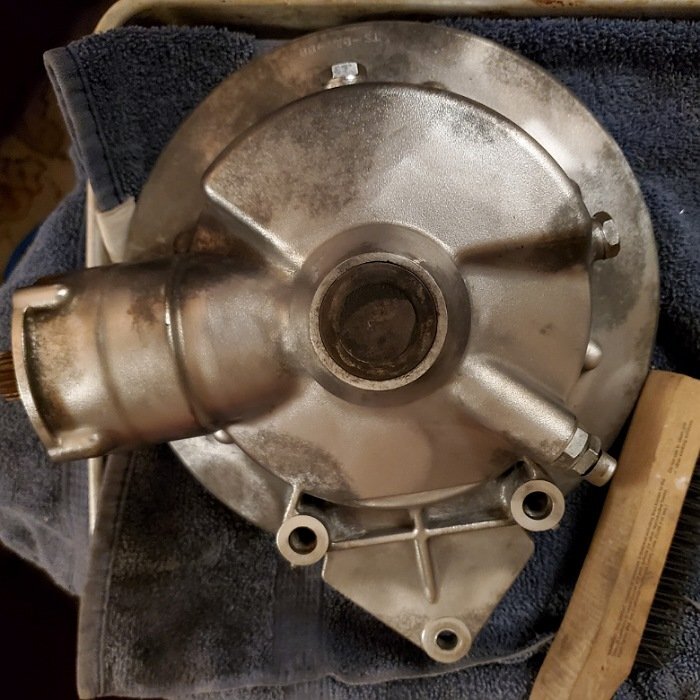

FreyZI Posted February 17, 2022 Author Posted February 17, 2022 Final drive is stripped and about ready for paint. Some unsightly areas where there was a lot of corrosion. I have both a semi-gloss and a crinkle paint. Will shoot a scrap of alu and see how they look. 1
docc Posted February 17, 2022 Posted February 17, 2022 On 2/17/2022 at 1:53 PM, FreyZI said: Final drive is stripped and about ready for paint. Some unsightly areas where there was a lot of corrosion. I have both a semi-gloss and a crinkle paint. Will shoot a scrap of alu and see how they look. Expand Ah, yes, the nefarious V11 Achille's Heel of the outboard (oft neglected) needle cage. Have you been able to inspect the nose of the crown wheel? Grease those needle cages liberally, and often, y'all!

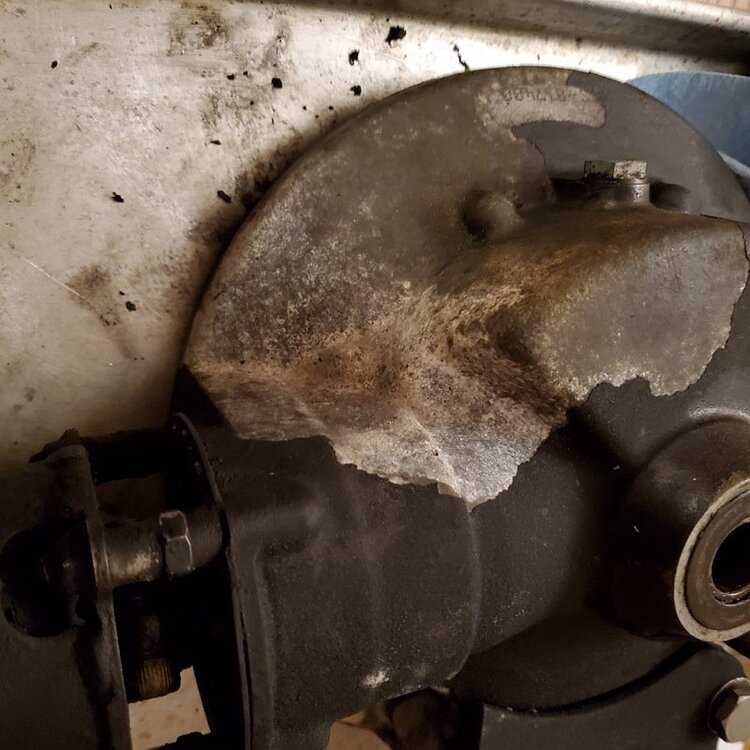

FreyZI Posted February 18, 2022 Author Posted February 18, 2022 On 2/17/2022 at 4:59 PM, docc said: Have you been able to inspect the nose of the crown wheel? Expand This is what I see: I haven't cracked the final drive open. I wasn't going to go there. But, I gather you're going to tell me that would be foolish...
docc Posted February 18, 2022 Posted February 18, 2022 On 2/18/2022 at 3:56 AM, FreyZI said: This is what I see: I haven't cracked the final drive open. I wasn't going to go there. But, I gather you're going to tell me that would be foolish... Expand Yes, the nose of the crown wheel is inside the reardrive. Yet, if it's not leaking perhaps best to leave it be?
