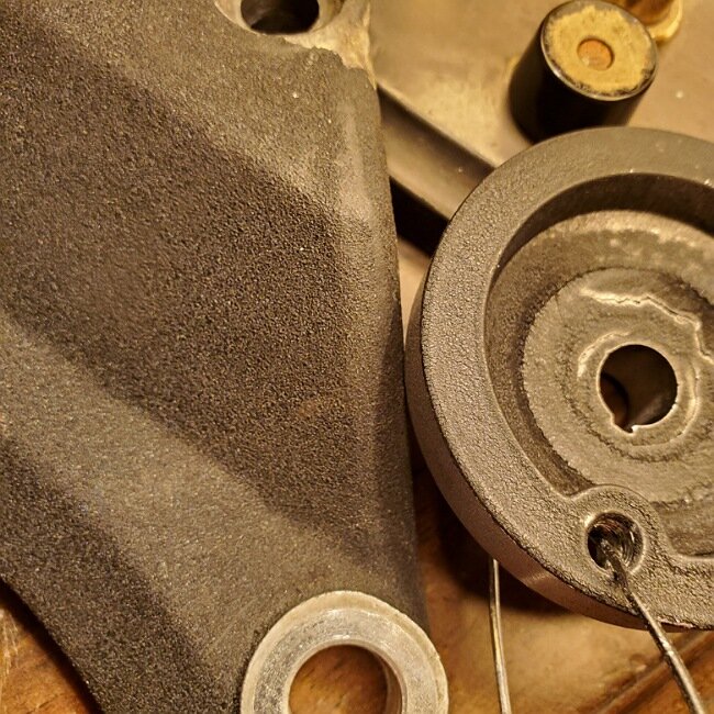

FreyZI Posted February 20, 2022 Author Posted February 20, 2022 10 hours ago, gstallons said: I'd leave it alone . Great. Now that we've decided that I will not screw around inside the final drive, I have to decide what paint to use. Here's a shot of the torsion bar bracket thingy with a cast alu piece I shot with some VHT wrinkle paint. Looks a pretty good match to my eye. I think I'll give this stuff a shot on the final drive. I had been leaning toward matching the swingarm, but this is so close to original I have to go with it. This particular paint can be air dried, but to "cure", the instructions say to put the painted pieces in an oven at 200F for 20 minutes. I did that with this piece. I'd like to do that with the final drive, too. I don't see any reason I can't stick the whole final drive in the oven at 200F for 20 minutes. I'd remove oil drain bolts, of course. I'd imagine most grease (P.O.x2 seems to have been a fan of red grease) would be okay up to that temperature. Cheers, Frey
Lucky Phil Posted February 20, 2022 Posted February 20, 2022 4 hours ago, FreyZI said: Great. Now that we've decided that I will not screw around inside the final drive, I have to decide what paint to use. Here's a shot of the torsion bar bracket thingy with a cast alu piece I shot with some VHT wrinkle paint. Looks a pretty good match to my eye. I think I'll give this stuff a shot on the final drive. I had been leaning toward matching the swingarm, but this is so close to original I have to go with it. This particular paint can be air dried, but to "cure", the instructions say to put the painted pieces in an oven at 200F for 20 minutes. I did that with this piece. I'd like to do that with the final drive, too. I don't see any reason I can't stick the whole final drive in the oven at 200F for 20 minutes. I'd remove oil drain bolts, of course. I'd imagine most grease (P.O.x2 seems to have been a fan of red grease) would be okay up to that temperature. Cheers, Frey You only need to cure VHT engine enamel for "Chemical resistance" read gasoline resistance. You could probably get away without the heat curing but if you have an oven and an understanding wife then it can't hurt anything. Personally I'd stay away from wrinkle finish paint. It collects dirt too easily and is hard to clean. looks nice but not in the "real world" Ciao 2
