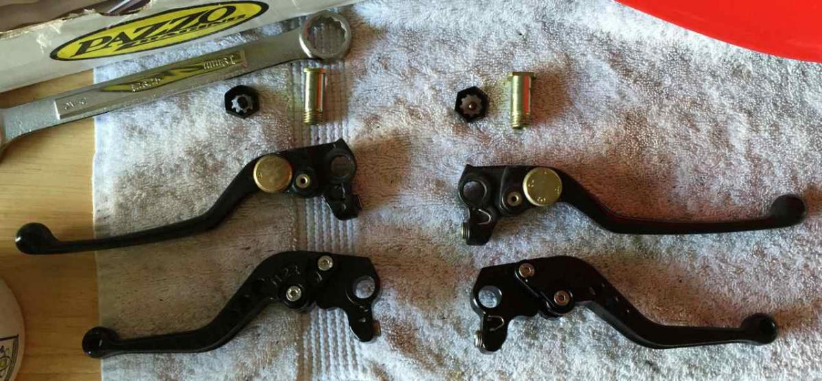

Scud Posted July 2, 2016 Author Posted July 2, 2016 OEM Part Name: Clutch and Brake Levers Moto Guzzi Part Number: Clutch Lever 01605640; Brake Lever 01605760 Replacement Part Brand or Source: Pazzo Part number or other identifier: Clutch DC-12; Brake DB-12 Differences from OEM (if any): 7 adjustment levels, superior feel, available as shorties that don't touch bar-end mirrors Other Compatible Vehicles: Many Ducatis that used the same master cylindersMonster M400: 1999-2003 Monster M600: 1994-2001 Monster M 620: 2002 Monster M750/M750IE: 1994-2002 Monster M900: 1994-99 900SS: 1991-97 748: up to 1998 916/916SPS: up to 1998 ST2: 1998-03 ST4/S/ABS: 1999-02 Other Comments: If you're looking for cheap, used levers, this increases your options on eBay. If you want the Pazzos (which I really like) they are available from many sources, including member FalcoLion's store, Moto World Online. Website link for source: http://www.motoworldonline.com/ http://www.motoworldonline.com/V11-Sport-Ballabio-LeMans-Coppa_c_947.html 2

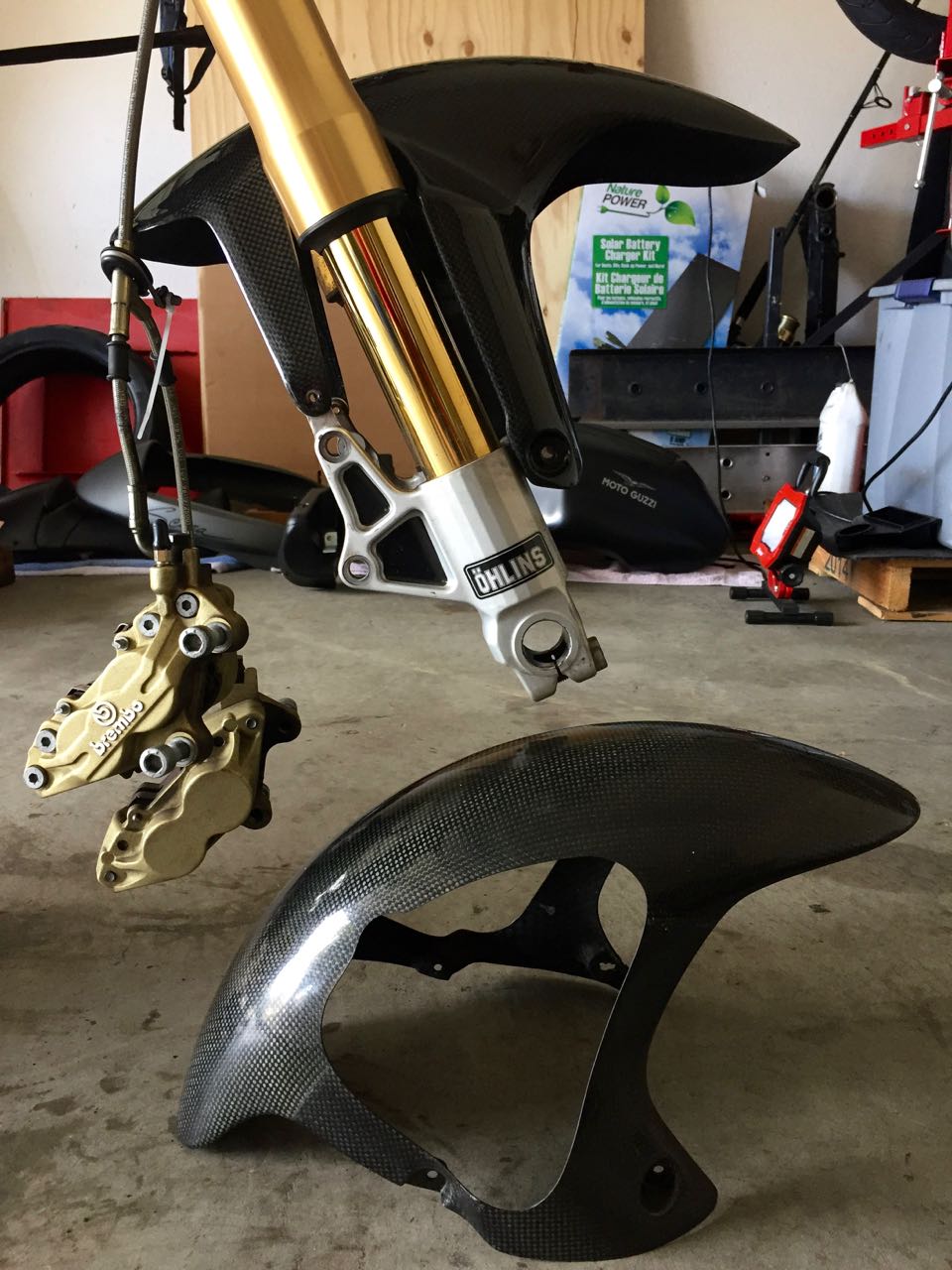

Scud Posted December 14, 2016 Author Posted December 14, 2016 OEM Part Name: Front Mudguard for Ohlins forks Moto Guzzi Part Number: 01434385 Replacement Part Differences from OEM: a bit shorter in back (possibly more road spray), more protection of fork sliders up front. Can be installed/removed with front wheel on bike (removal of OEM fender requires wheel removal) Other Compatible Vehicles: 1998-2003 Aprilia RSV Mille, 2002-2005 Aprilia Tuono Other Comments: excellent quality carbon fiber Website link for source: found on eBay from a seller in Hong Kong 1
