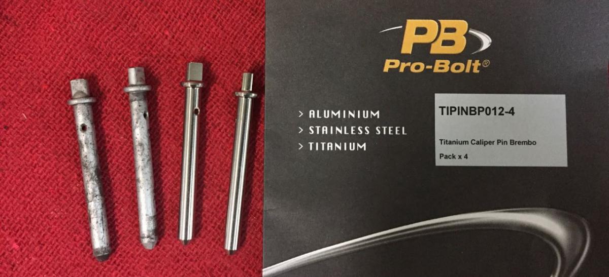

OEM Part
  • Name: Front Brake Caliper Pins
  • Moto Guzzi Part Number: couldn't find a part number
Replacement Part
  • Brand or Source: Pro-Bolt
  • Part number: TIPINBP012-4
  • Differences from OEM: These are titanium, and the manufacturer claims they last longer than the original Brembo pins.
  • Other Comments: At first glance I thought they were thinner than the Brembo part, but they measured exactly the same diameter (digital caliper). They look thinner in the picture too, but that is an optical illusion...  They are available in different colors, the supplied part number is for a 4-pack.

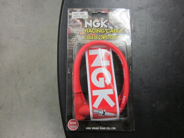

OEM Part
  • Name: Spark Plug Wire
  • Moto Guzzi Part Number: Spark Plug Wire-GU01718330, Spark Plug Cap-GU01717430
Replacement Part
  • Brand or Source: NGK
  • Part Number: CR6
  • Virtually the same wire and plug, the NGK has outer sleeve covering plug wire to protect from the elements/heat. The sleeve is the same red color as plug wire and could be removed.
  • Other Comments: I removed the end connector from the original wire (end that plugs into the coil) and installed it on the new NGK wire since the NGK package does not provide one. It does come with the Spark Plug Cap already installed. They only come one to a pack, so naturally you would require two if you were to replace both stock wires.

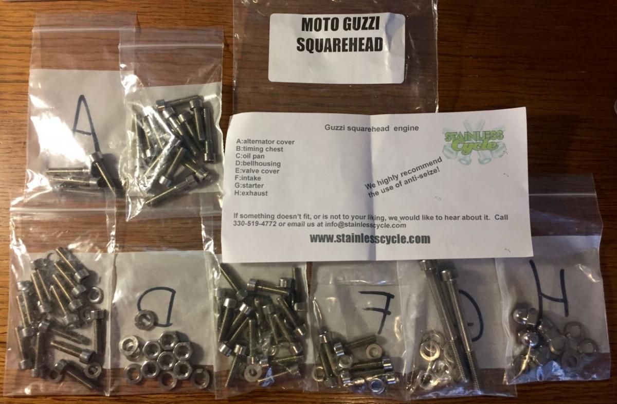

OEM Part
  • Name: Stainless Steel Bolt Kit
  • Moto Guzzi Part Number: N/A (or all bolts and washers have separate numbers, which I am not going to look up)
Replacement Part
  • Brand or Source:  StainlessCycle.com
  • Part number or other identifier: Moto Guzzi Squarehead
  • Differences from OEM (if any): stainless hardware - all bolts are allen-head caps - not phillips (alt cover) or standard bolt-heads (starter).
  • Other Comments: includes correct bolts and different types of washers for alternator cover, timing chest, oil pan, bell-housing, valve covers, intake ports, starter, and exhaust flanges.  And they "highly recommend the use of anti-seize!"
  • Website link for source:  http://www.stainlesscycle.com/presta/en/53-moto-guzzi

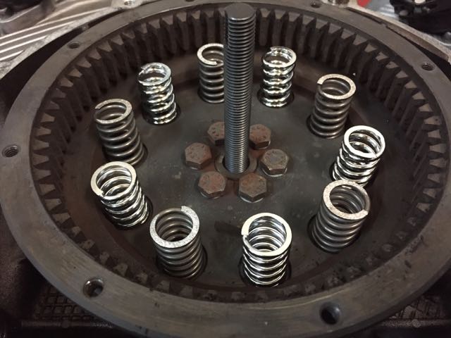

OEM Part
  • Name: clutch spring for twin disc, 10-spring clutches
  • Moto Guzzi Part Number: 04084100
Replacement Part
  • Brand or Source: MG Cycle
  • Part number or other identifier: 12082300 (heavy) and 04084100 (light)
  • Differences from OEM (if any): The heavy springs are much stiffer than stock, the light ones feel about the same
  • Other Compatible Vehicles: same for many big twin Guzzis
  • Other Comments: When I put 10 heavy springs in, the clutch lever required a lot of effort and a full pull to the handlebar. I learned, through MG Cycle, that Moto Guzzi alternated light and heavy clutch springs. When I used 5 of each, I got a more reasonable lever effort and the clutch released mid-way through the pull.
  • Website link for source: MG Cycle (probably other sources too)
Link to Further Discussion or Tips:
Same thread as for the plates:  http://www.v11lemans...showtopic=19808
The brightest chrome springs are the heavy ones, the others are new light ones. It seems to me that using 5 new heavy springs and re-using 5 of the original springs would be fine, but I have not tried that.
