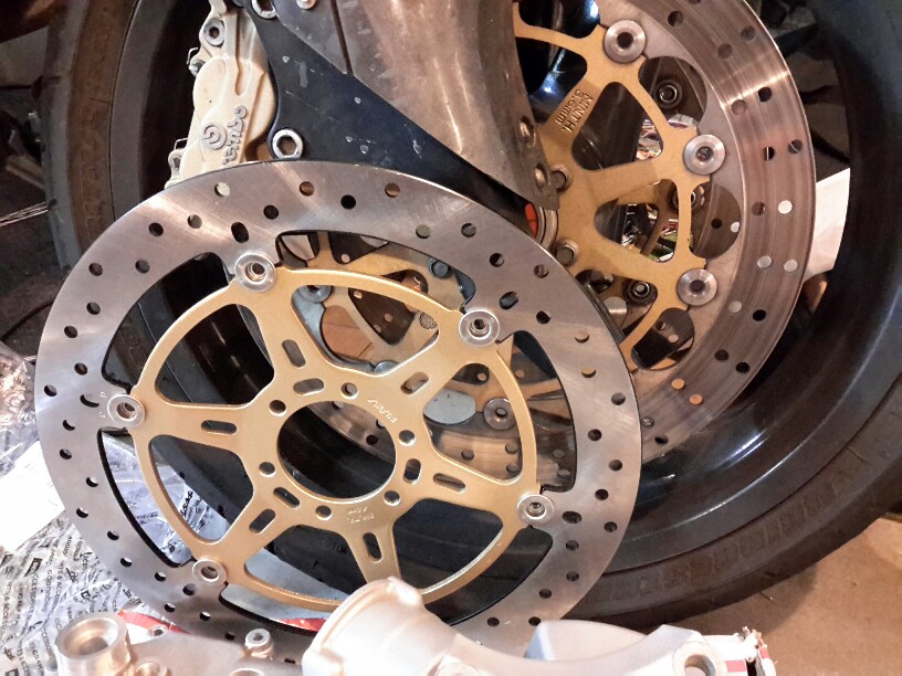

OEM Part
Name: Front Brake Disk. If your disks are thinner than 3.6mm, then it is time.
Moto Guzzi Part Number: GU 01613330
Replacement Part
Part number: AP8133781
Brand: Sunstar. "Vespa APC Aprilia Derbi Gilera Piaggio Scarabeo genuine spare parts" written on packaging.
Source: AF1 Racing https://www.af1racing.com/store/Scripts/prodView.asp?idproduct=5809
Differences from OEM: Less spokes, looks like it should be lighter, offset looks the same, will report back after I fit them.
Other Comments: Much cheaper than Brembo disks, even with $83 shipping to NZ.
Fit fine and work well.
Edited by MartyNZ
After fitting to bike

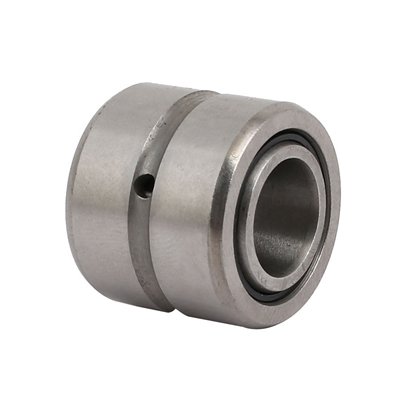

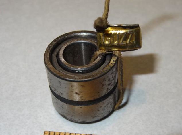

OEM Part
  • Name:  Oil Pump Roller Bearing 10x22x20
  • Moto Guzzi Part Number:  GU 92252210
Replacement Part
I just ordered one on Amazon for $20 delivered. Harper's has them for $42, MG Cycle doesn't have them at all. So I thought it might be helpful to post an alternative. Crusty looking photo is the oem part from Harper's:
This photo is from the the VXB website:
