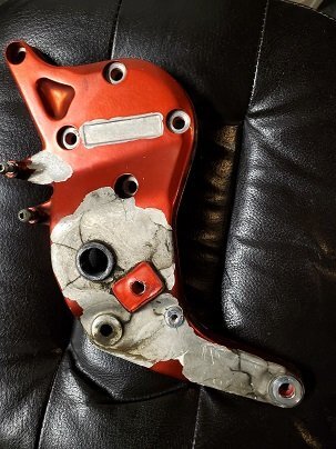

Removed side plate (one side at a time; replaced with nice silver plates).  The pic below is the left plate just with me picking off the loose flakes.
I've read in other posts that the pot metal Guzzi used on these pork cops has so many impurities that off-gassing during powder coating baking has lead to not great results.  Likewise, some have said that anodized finish is not good.  Some have had success with paint under clear.
These parts clearly take a beating, so I'd like as durable a finish as possible.  Also, I'd be happy to drop these of at my local powder coater and have them deal with it instead of me goofing it up with paint.  Has anyone out there had success with anodizing or powder coating pork chops?  If not, I'll order some paint.

Those look like cracks to me. :o I would look at them long and hard before deciding they were sound.
Chuck, what look like cracks in the metal are in fact where the cracks in the finish were before I peeled the loose finish off.  The grime accumulated under those cracks and remained there giving the appearance of cracks in the metal.
FWIW, the cracks in the finish "may" have been caused by the pork chop taking a hit. If it were mine, I'd NDT it. Hard to tell from a picture, of course. :huh2:

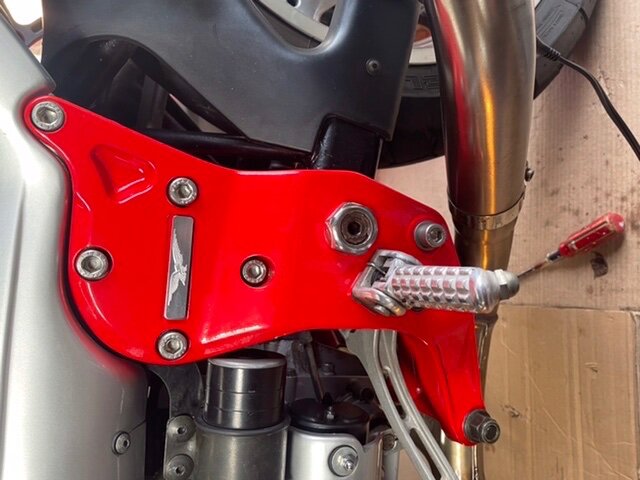

I’ve had 2 sets of pork chops powder coated at a local powder coating shop. They shot blasted the old finish off, and masked the threads with excellent results. Much more durable than the original red paint (these are off red frame bikes), and no issues with longevity. This one was done 2 years ago and it’s pristine
  • Like 3

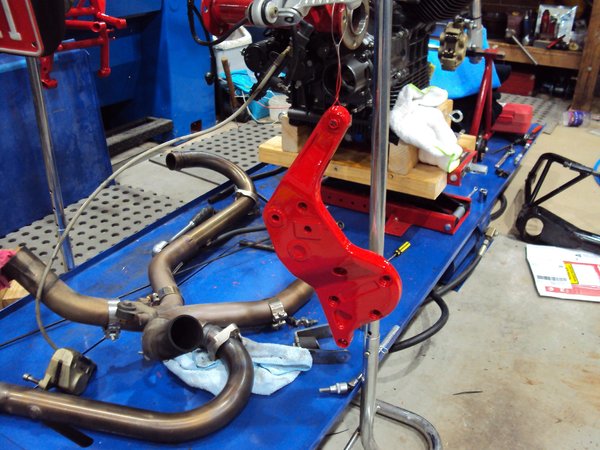

Flat black powder coating generously applied to pork chops and many other bits.

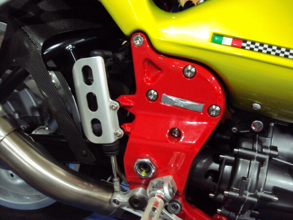

Candy apple red plates and covers on Champagne.
Close up of those same candy-red plates that I migrated to the Nero Corsa.
