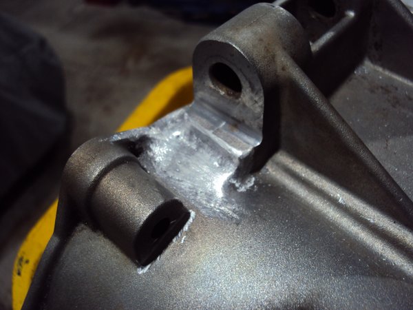

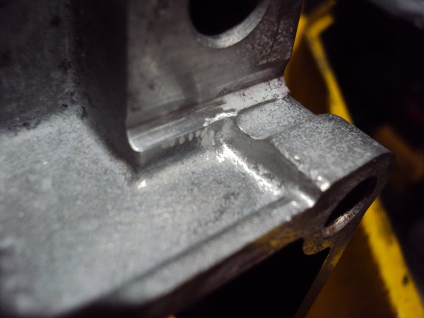

Pressureangle Posted February 9, 2022 Posted February 9, 2022 On 2/9/2022 at 1:35 AM, laurent said: It is leaking gearbox oil/cracked through Expand That crack quite visibly runs along the hard machined corner. Poor machining practice in a stressed area. It should have a radius in the fillet. 1
Chuck Posted February 9, 2022 Posted February 9, 2022 Yeah, the cutter should have had a radius. Luigi must have been promoted to manufacturing processes. 2 1
Lucky Phil Posted February 9, 2022 Posted February 9, 2022 On 2/9/2022 at 7:53 PM, Chuck said: Yeah, the cutter should have had a radius. Luigi must have been promoted to manufacturing processes. Expand Yes Chuck on the LHS mount you're right. My repair was to the RHS mount so thats where my head space was. I removed this sharp corner on mine with a small round file wrapped in and wet and dry to finish it off although mine wasn't cracked here. It did undercut the mount a little but the trade off was worth it in my view. I also dressed the radii on all the sharp corners with the die grinder and a tiny ball shaped cutter as well which you can see in the images. I also did the same on the RHS mount although this isn't where mine was cracked. I'd have prefered to do it with a small Bull nosed cutter in the mill but I didn't have the facility. My repair looked a lot nicer before I peened and dressed it back. It's rock solid now though. 2 1
Scud Posted February 9, 2022 Posted February 9, 2022 Sorry to Laurent about your transmission, but thanks for posting it so we can all get a free lesson in mechanical engineering. In retrospect, it seems Moto Guzzi solved this problem by stiffening up the subframe and adding the arms to the block. But it could have been solved with a change to the mold for the transmission case, and changes to the final machining of the contact surfaces. Interesting. And lest we forget, this was Moto Guzzi's first 6-speed, and it was the best transmission they had ever built at the time. 5
