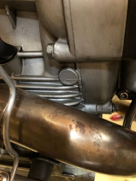

laurent Posted March 10, 2022 Author Posted March 10, 2022 Ok here the follow up. I took my courage (I am new at TIG welding) in hands and built a bracket which I welded to the frame. Then installed the bracket I got from Motivcycle works. As an experiment and to give me more time to find another gearbox /solution I have JB fixed the crack really cleaning it well beforehand. I will feedback and let you know if it is going to leak again....or not:). Also I made a spacer for the gearbox mount, it fits between the lugs and prevents any tension when tightening the bolt P.s tried to buy a new housing and no one sells them anymore. Now it's either welding or getting a good second hand box. Here some pictures https://1drv.ms/f/s!AvMw5i-09AkLwAf796UfANGWc3b_ 2
