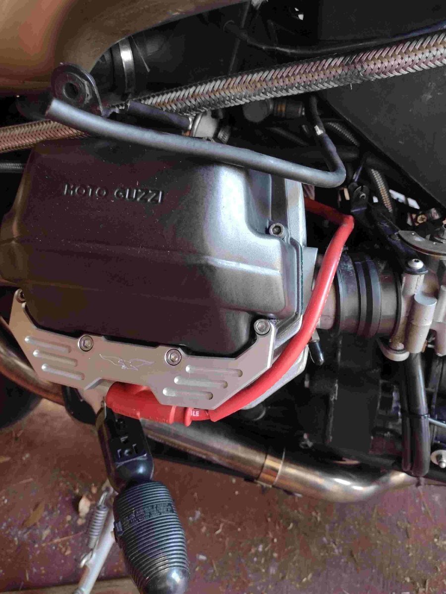

dbarb3 Posted March 8, 2022 Author Share Posted March 8, 2022 Checked cable routing , intake rubbers, fuel filter installation. Petcock is flowing freely. I found this little fellow under the tank, it routes out to the bottom of sump. It seems to be a vacuum hose to something but would vent directly to the ground. Link to comment Share on other sites More sharing options...
O2 V11 Posted March 8, 2022 Share Posted March 8, 2022 It could be either your tank vent or drain. There are two outlets on the bottom of the tank. One is a drain for any liquids that my be present around the filler ring and the other is a vent for any pressure that may build up inside the filler cap. If your bike originally was a CA spec one, the vent line would have been plumbed into the filter canister. This is generally removed and both lines a joined with a small joiner to the drain line and are discharged down at the rear of the sump. This is where the drain line is routed. For this I used a small garden irrigation "Y". I am unsure how the vent system is structured on non CA spec bikes. Rob 2 Link to comment Share on other sites More sharing options...
dbarb3 Posted March 8, 2022 Author Share Posted March 8, 2022 already have a line on both tank nipples, I'm grasping for straws cause this idle issue surely sounds like some type of vacuum/air issue Link to comment Share on other sites More sharing options...
