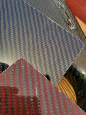

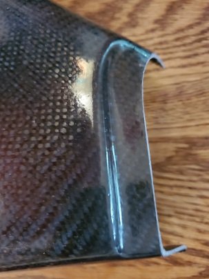

FreyZI Posted August 10, 2022 Author Posted August 10, 2022 Note that these pieces are prototypes, not final product. There are a few rough edges, holes are not yet holes, and I presume the CF was laid a bit quickly. Even with the final product, you will know that this is hand-laid fiber. To me, that's a plus -- and similar to the rest of the CF bits on my bike. If you're not okay with that, walk away. First up, a pic of the humps: Prototype at north. Note that this was an attempt to replicate the more satin finish of the vacuum-method pieces. I am not a fan. Next up, the side cover. Original on right. If people want these, we should figure out what to do about the depression for the gummy stickers (wanted or not). Next, a close up of the samples of the Kevlar weaves. They are leaning against the prototype side panel with regular 2x2 CF weave. 4 1

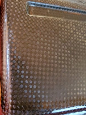

FreyZI Posted August 10, 2022 Author Posted August 10, 2022 A closer shot of the prototype side cover showing somewhat the weave and hand-laid character.
FreyZI Posted August 10, 2022 Author Posted August 10, 2022 On 8/3/2022 at 12:24 AM, Stumble_t said: I’ve still got an outstanding open question on what weave/finish will match the factory CF bodywork on the Cafè Sport though. I’d hope to get that answered before I had to make a decision. Just realized looking at pics online that Tenni doesn't appear to have any CF from factory. I bought my Tenni with all the CF bits. Side cover I believe to be an MG product, judging from sticker. It appears to be 1x1 weave. But, my Mistral mufflers are very clearly -- like Docc's -- 2x2 weave. 2
FreyZI Posted August 10, 2022 Author Posted August 10, 2022 BTW, every other CF part on my Tenni is also 1x1 weave except for the hugger. 1x1 looks like a checker board. 2x2 looks like diagonal blocky lines. 1x1 is also called plain weave, and 2x2 is sometimes called twill weave. 3 1

Rox Lemans Posted September 22, 2022 Posted September 22, 2022 On 8/10/2022 at 10:36 AM, FreyZI said: Note that these pieces are prototypes, not final product. There are a few rough edges, holes are not yet holes, and I presume the CF was laid a bit quickly. Even with the final product, you will know that this is hand-laid fiber. To me, that's a plus -- and similar to the rest of the CF bits on my bike. If you're not okay with that, walk away. First up, a pic of the humps: Prototype at north. Note that this was an attempt to replicate the more satin finish of the vacuum-method pieces. I am not a fan. Next up, the side cover. Original on right. If people want these, we should figure out what to do about the depression for the gummy stickers (wanted or not). Next, a close up of the samples of the Kevlar weaves. They are leaning against the prototype side panel with regular 2x2 CF weave. The seat cowlings look good. I'll take em.. 😃👍 1
PhillipLarsen Posted September 22, 2022 Posted September 22, 2022 I see there is some consideration of using Kevlar. My recommendation would be not to, based on some experience about 25 years ago when i worked as a design engineer for an airline, and we had new Airbus A320 aircraft that had Kevlar in many of the the belly panel. The environment in this location subjects them to hydraulic oil and Skydrol from leaks as well as a lot of water and humidity. The panels absorbed oils into the the panel from the edges where they were trimmed during production, using the Kevlar to wick into the panel saturating the core material and turning the ridged panels to mush. Airbus ended up having to replace all the belly panels with Kevlar with new Carbon fiber or fiberglass panels on the early serial number planes that had them. Cost a fortune. The original design goal of the Kevlar was for durability. 1
Stumble_t Posted September 22, 2022 Posted September 22, 2022 On 8/10/2022 at 10:54 AM, FreyZI said: Just realized looking at pics online that Tenni doesn't appear to have any CF from factory. I bought my Tenni with all the CF bits. Side cover I believe to be an MG product, judging from sticker. It appears to be 1x1 weave. But, my Mistral mufflers are very clearly -- like Docc's -- 2x2 weave. My Mistral Carbon cans are for sure a larger weave than the bodywork on the Café Sport as well. Sounds like the 1x1 is the way to go. Thanks for the research FreyZI!
Rox Lemans Posted September 22, 2022 Posted September 22, 2022 6 hours ago, Stumble_t said: My Mistral Carbon cans are for sure a larger weave than the bodywork on the Café Sport as well. Sounds like the 1x1 is the way to go. Thanks for the research FreyZI! One valuable time consuming lesson I've learned.. : Never try matching up carbon weave. You'll pull your hair out (if you still have any). My Scura carbon barely matched from the factory.. 🤣 Now I have Stucchi, M4, and some other stuff. It's all different.. Still looks good but you know it ain't factory. Guzzi had to of used 100s of different carbon weaves through the years. 1
