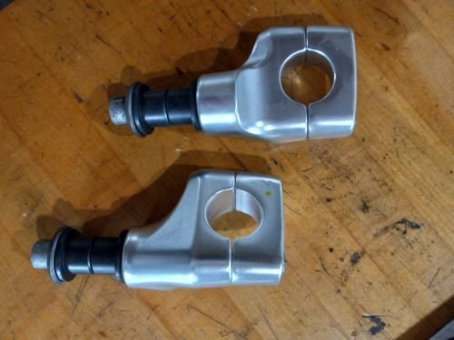

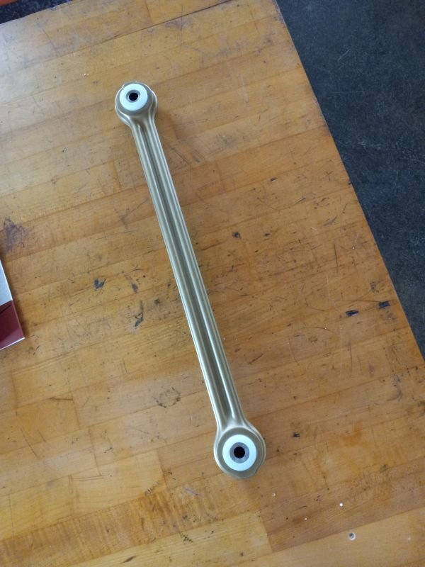

Cold Desert Rat Posted June 3, 2022 Author Posted June 3, 2022 UHMW polyethylene bushings. I melted the sleeves out of the old rubber bushes and pressed them into the new bushes. 2

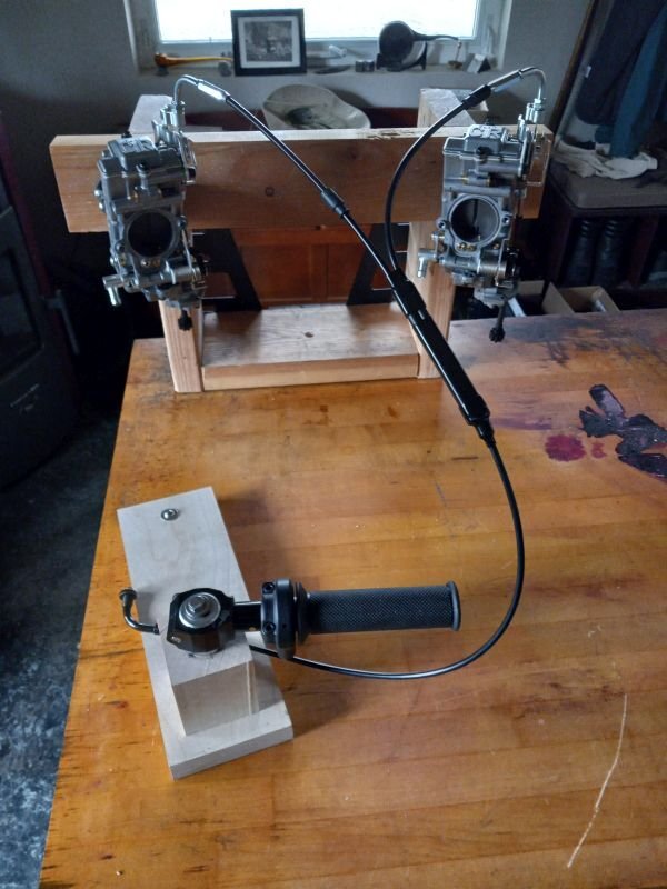

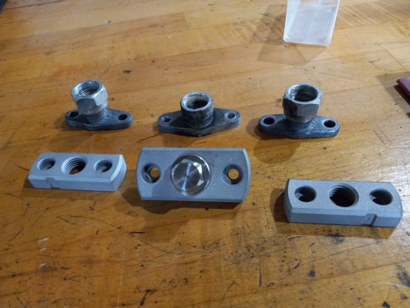

Cold Desert Rat Posted June 3, 2022 Author Posted June 3, 2022 Even with the original part number the throttle cable from Motion Pro was incorrect. And very expensive. I'm gonna roll my own. Here's my test stand. 3

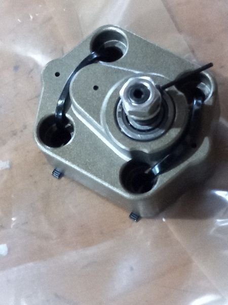

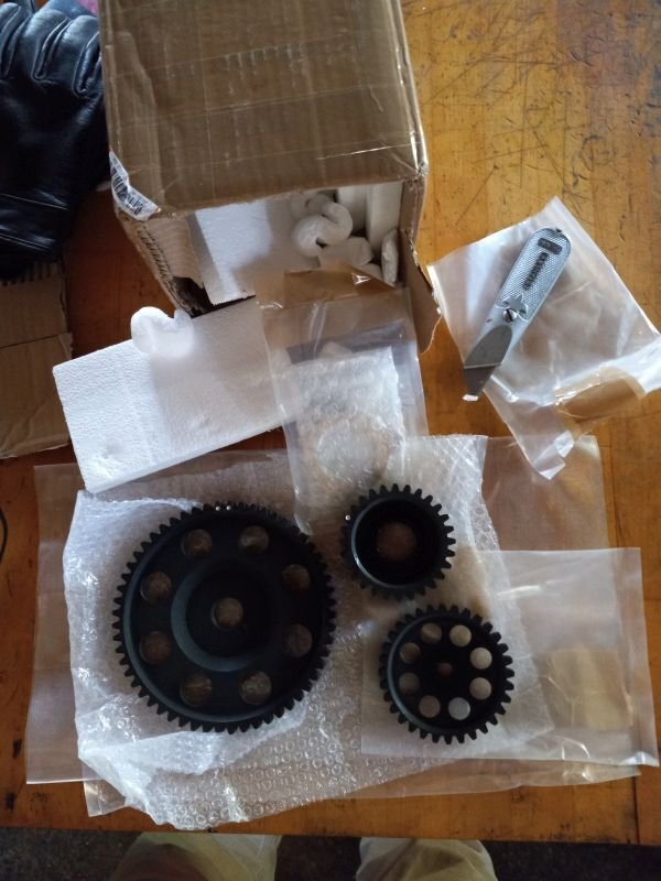

Cold Desert Rat Posted June 3, 2022 Author Posted June 3, 2022 I couldn't resist G. Caruso's oil pump 2

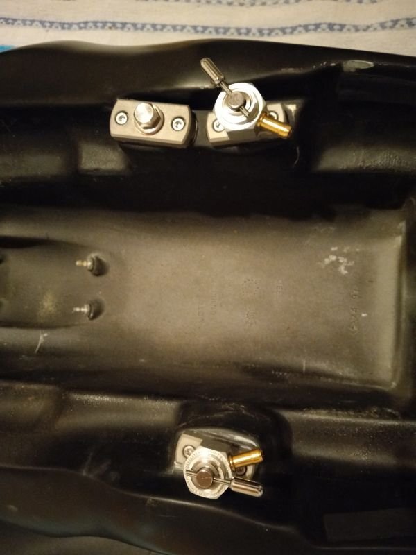

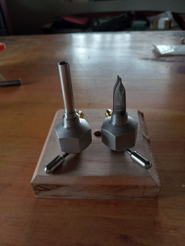

docc Posted June 3, 2022 Posted June 3, 2022 17 minutes ago, Cold Desert Rat said: Petcocks. Oh! Right! With carburetors, no more regulator and a petcock for each side. No more trapped fuel!
Cold Desert Rat Posted June 3, 2022 Author Posted June 3, 2022 Thanks Docc! Very kind of you. This was a happy day.
docc Posted June 3, 2022 Posted June 3, 2022 This build rocks! Thanks for the updates (teases), @Cold Desert Rat ! Isn't this the best packed anything you've ever gotten from anywhere? 1
Cold Desert Rat Posted June 3, 2022 Author Posted June 3, 2022 Docc, Mr. Caruso is every bit the proper, reserved English gentleman. Wonderful man who makes magic. Did you notice the gears even smell good when you get them? How does he do it. And yes, that box was as thoroughly and perfectly packed as you would expect. The build won't be done this season. It's not even money. It's just impossible to get things and/or get things done. Don't get me started...... Back to MG: So much of modern design is so ugly. By design, I would say. But working on the Guzzi always brings me joy. Somebody cared what those handle bar mounts looked like. I could have picked a Brembo brake lever or any number of beautiful items on the bike. My photography doesn't do justice to the tactile and graceful beauty of the parts. When I am too old to ride I will park it in front of the fire and look at it. 1
Lucky Phil Posted June 3, 2022 Posted June 3, 2022 3 hours ago, Cold Desert Rat said: Even with the original part number the throttle cable from Motion Pro was incorrect. And very expensive. I'm gonna roll my own. Here's my test stand. Carburettors and pod filters as well I suspect. Sigh Ciao
