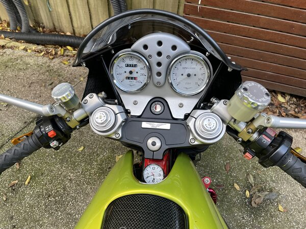

Lucky Phil Posted January 7, 2024 Posted January 7, 2024 35 minutes ago, Gmc28 said: Hi Phil- that’s what I was thinking. I got the bike that way, and I think that’s what I’ll do (paint), though the chrome finish will be another thing. The original triple is painted silver. I went with a stainless steel yoke nut and a black rubber grommet. I'm not a fan of chrome personally on the V11 Sport. Phil
Lucky Phil Posted January 7, 2024 Posted January 7, 2024 1 hour ago, Gmc28 said: That’s a great idea Forgot the image. 2
Gmc28 Posted January 7, 2024 Author Posted January 7, 2024 Perfect. You went black… I like that. But I also see I didn’t think to paint the backside of the fly-screen fairing. Didn’t occur to me till I saw yours. And which mirrors do you have? I think you’ve noted which they are in other posts. I forgot how beautiful your greenie is. Will stare more at some of your photos for ideas. Where’d you source that top stainless yoke nut? I’ve got some likely sources here local that I can check.
Lucky Phil Posted January 7, 2024 Posted January 7, 2024 4 hours ago, Gmc28 said: Perfect. You went black… I like that. But I also see I didn’t think to paint the backside of the fly-screen fairing. Didn’t occur to me till I saw yours. And which mirrors do you have? I think you’ve noted which they are in other posts. I forgot how beautiful your greenie is. Will stare more at some of your photos for ideas. Where’d you source that top stainless yoke nut? I’ve got some likely sources here local that I can check. Rizoma mirrors. I have a set of knock off the same in matt black on my Enfield but they are disappointing in that the ball adjusters are so tight they are unuseable. If you knock them out of adjustment you need to loosen the mounts to re align. Just buy Rizomas, expensive but quality. The top nut came from Stein Dinse. Phil 2
