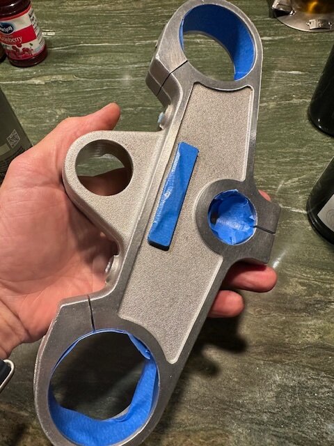

Gmc28 Posted February 9, 2024 Author Posted February 9, 2024 On 1/6/2024 at 9:23 PM, Lucky Phil said: The original triple is painted silver. I went with a stainless steel yoke nut and a black rubber grommet. I'm not a fan of chrome personally on the V11 Sport. Phil Decided for now to strip it then clear coat the aluminum (cast) piece, as I wasn’t loving the idea of layers of primer and paint, and all the exposed transition edges. So far it’s looking ok, way better than the damaged aluminum-colored paint that I got it with, but will be easy to pull and do again if I don’t like how it looks on the bike. Got a little carried away with the 600 grit in a couple spots, and didn’t want to buff it any more and get it any shinier, as too much shine is what will make it not look right on the bike. We’ll see. And Stein Dinse delivered the new stainless nut today. So re-assembly can commence this weekend, and maybe get ‘er runnin finally, soon. 2
Lucky Phil Posted February 9, 2024 Posted February 9, 2024 3 hours ago, Gmc28 said: Decided for now to strip it then clear coat the aluminum (cast) piece, as I wasn’t loving the idea of layers of primer and paint, and all the exposed transition edges. So far it’s looking ok, way better than the damaged aluminum-colored paint that I got it with, but will be easy to pull and do again if I don’t like how it looks on the bike. Got a little carried away with the 600 grit in a couple spots, and didn’t want to buff it any more and get it any shinier, as too much shine is what will make it not look right on the bike. We’ll see. And Stein Dinse delivered the new stainless nut today. So re-assembly can commence this weekend, and maybe get ‘er runnin finally, soon. Green Scotchbrite gives the best satin finish to aluminium. 2
Gmc28 Posted February 9, 2024 Author Posted February 9, 2024 Agreed….I used the scotchbrite for most of the cleanup originally, but had the 600 out at the end to quickly address a bit of orange-peel in one area. I got a little carried away with it, assuming the 600 wouldn’t actually have much “cut”, but misjudged a bit. Also took the opportunity to pull flyscreen off and hit the un-finished backside with some satin black. I’ll sleep better at night now… 1 2

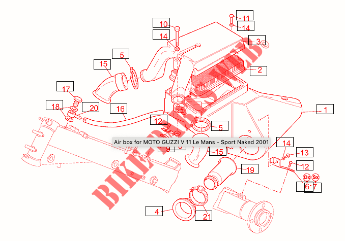

Gmc28 Posted February 13, 2024 Author Posted February 13, 2024 had a little time to do some reassembly on Greenie last weekend, after have her bits laid on shelves for last couple years. All good, except the top, forward frame vent hose (just behind good neck, no top, front of tank) I see is just capped with a bolt. PO removed the airbox and installed pods, which i'm leaving alone for now (for various reasons), so that hose that would terminate at the airbox is now plugged. Question is whether plugging it is ok. I got the bike that way from PO, but a lot of stuff wasn't right on the bike, and I'd think thats the case here. I'd think that would need to vent, so i'll look into best way to do that, but thoughts on that? Hose 16 on web sourced diagram from a spine frame of some sort...
audiomick Posted February 13, 2024 Posted February 13, 2024 21 minutes ago, Gmc28 said: ... so that hose that would terminate at the airbox is now plugged. Question is whether plugging it is ok. ... I'd think that would need to vent, If the frame is still part of the breather system as it was originally intended, then I agree with you. That would most likely need to vent. I have read stuff on numerous occasions regarding the same situation on various different Guzzis, and seen the solution in practice a couple of times, i.e. no airbox, so where do I vent the breather to? The commonest solution seems to be to put a longish hose on the connecter, and just stick the other end into an empty Jim Beam and Cola can, or some similar container, to catch any drips that might happen. Check the can occasionally to see how much is coming out that way (should be practically nothing) and empty it if required.
LaGrasta Posted February 13, 2024 Posted February 13, 2024 yes, you can plug it, but there is no need; you can leave it open.
Gmc28 Posted February 13, 2024 Author Posted February 13, 2024 audiomick and lagrasta, all sounds good. I saw some of those threads, where folks talked about a lot of oil coming from the breather/system, and some saying that wasn't the case for them, but those seemed to all be in regard to the actual case vent (hose). On this greenie the breather hose is in place and looks intact, the infamous one that is prone to failure (crack/leak), as is the return line which goes down to the oil pan, so the essentials are in place. Hard to imagine not letting it "breath" from the 3rd, top-most hose would be an issue, but thats what i'm noodling.... 1
MartyNZ Posted February 13, 2024 Posted February 13, 2024 Crankcase pressure is always more than ambient due to piston ring blowby, however slight. This is unavoidable on all piston engines unless you have an unusual feature like a scavenge pump. For this reason, crankcase pressure will slowly build until it finds an escape path. If you block the vent going to the airbox, the pressure will rise until it relieves somewhere else, possibly showing as an oil leak. I don't think you should block that hose. 2
Lucky Phil Posted February 13, 2024 Posted February 13, 2024 9 minutes ago, MartyNZ said: Crankcase pressure is always more than ambient due to piston ring blowby. This is unavoidable on all piston engines unless you have an unusual feature like a scavenge pump. For this reason, crankcase pressure will build until it finds an escape path. If you block the vent going to the airbox, the pressure will build until it relieves somewhere else, possibly showing as an oil leak. I don't think you should block that hose. Correct you should not plug the line to the airbox or the crankcases cant vent. If you have positive CC pressure due to blow by then you have a real issue. Most of what people see coming from the PCV or CC vent is air movement due to the pumping process of the pistons. It's easier for the CC air being pumped around by the rising and falling pistons to vent out the breather than follow the sometimes convoluted internal route to the underside of the rising piston. Sometimes CC pressure can briefly go to zero or a little below on a wet sump engine that uses a reed valve in the breather such as Ducati twins have for years and years. As the CC air is expelled out the breather any slight pressure is vented and the reed valve then closes and the CC pressure will go to zero or fractionally below very briefly. Phil 3
