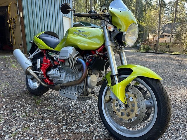

Gmc28 Posted April 2, 2024 Author Posted April 2, 2024 Finally got a chance to pull her off the stand and get her out on the road, for a run-in-the-sun down to the local ethanol-free gas station. Proof of life. She has a different feel than the Lemans(s), or at least more than I had expected. She starts, idles, and runs sweet, but is a bit more buzzy at some rpm's (pods/airflow/TBS, etc), and I feel as though she's a lot smaller for my tall-ish body than the Lemans, though I know that's mostly in my head. Now back to Goldie, to see if I can get her ready for the June 28 MG gathering at John Day, for my Guzzi buddy to ride (i'll be on Red) 4
