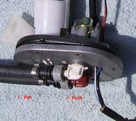

Guest Fonzarelli Posted April 8, 2004 Posted April 8, 2004 I have removed my tank three times. I agree that the first time the connectors seem odd, but they will disconnect. Push the grey collar toward the fuel hose while holding the fuel hose stationary. I have also removed the fuel hose and fitting by simply pushing the grey collar toward the hose allowing it to pop off. Simply press the fitting back on the pump barb to reconnect.
Mr. Bean Posted April 9, 2004 Posted April 9, 2004 I just tried my QD's using Frank and Fonzarelli's advice....It worked only on mine it was backward! I tried doing it by pushing the grey collar toward the hose (away from the red and white connectors) and they would not come free. As soon as I tried pulling the collar AWAY from the hose and toward the tank connector while at the same time pulling the HOSE away from the connector..off they came easy as can be. I reinstalled and repeated each a couple times like I had done it my whole life...very cool. These sure beat my old MZ for convenience! Randy
al_roethlisberger Posted April 9, 2004 Author Posted April 9, 2004 Whoo Hoo.... SUCCESS!! I don't know what changed, but I pulled on the hose, and pushed on gray collar toward the hose(again)... and off they both popped with no drama I think that maybe because I soaked them with WD-40 last night, then let them sit all day... that might have helped. Maybe they were just frozen on a bit after sitting for so long with no fuel on them, etc... Anyway, they work like a charm, awesome... no more hose clamps al What worked:
