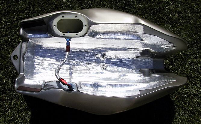

al_roethlisberger Posted May 9, 2004 Author Share Posted May 9, 2004 Here is the balance tube installed on the bottom of the 2003 tank. It isn't ideal, as one side(the pump side) is a bit higher as that's the lowest point on the right side of the tank, but it will still "balance" the two sides of the tank to some degree with no "sloshing".... ideally providing access to I guess about 70% of the "isolated" fuel on the left side. Link to comment Share on other sites More sharing options...
