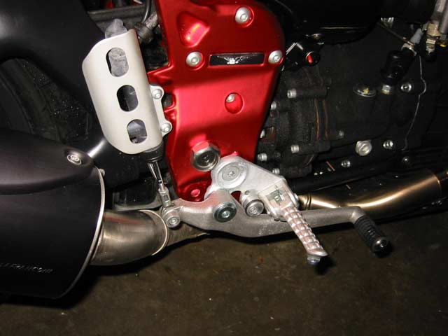

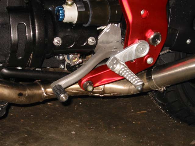

Guest dkgross Posted May 10, 2004 Posted May 10, 2004 sorry I took so long.. fwiw...I don't think I'd go with the Cenaturo setup if I had to do it all again. There's just not enough difference, and I don't like the look of it that much. I miss the other pegs...Might put them back on someday...
al_roethlisberger Posted May 10, 2004 Posted May 10, 2004 Thanks Interesting feedback, as it looks to me like they would seem to make a BIG difference in ergos. Maybe in combination with the TB bars, you can't tell so much?? I bet in combination with the stock bars, the difference would be quite noticeable, perhaps more than with the new bars in combination They do look a bit bulkier than the stock solution, but other than the custom plate for the shift linkage, this looks like it could be a good solution for many folks Thanks again for the great photos. I'm sure that will help a lot of folks making their decisions. al

Guest dkgross Posted May 10, 2004 Posted May 10, 2004 Interesting feedback, as it looks to me like they would seem to make a BIG difference in ergos. I guess it's just hard to say. I'm only 5'8", so on a taller rider, it probably would. I took a stock Rosso for a spin, and my feet didn't bother me once I readjusted..I sort of even didn't mind the stock bars, but, I'm not switching back

dlaing Posted February 2, 2006 Posted February 2, 2006 what brand peg /shifter setup is that? 76899[/snapback] Moto Guzzi Centauro pegs/shifter/pedal on a LeMans
dlaing Posted February 2, 2006 Posted February 2, 2006 Centauro They are pretty cool because of the adjustability. Unfortunately I don't think you can turn them to the rearset position.
