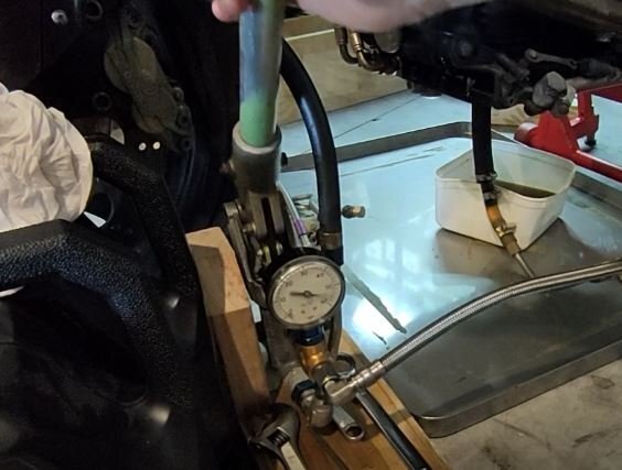

MartyNZ Posted July 16, 2022 Posted July 16, 2022 1 hour ago, Lucky Phil said: If it's not the filter gasket then the oil pumps lost its prime... I used a small hand pump to prime my bike after the sump was off for weeks. I didn't know if it had lost prime, but I thought it wouldn't do any harm. As Phil suggested, I pumped oil into the pick-up tube which pokes down into the sump screen. 1
