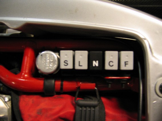

docc Posted April 30, 2004 Share Posted April 30, 2004 here's a photo with the relays labeled. it is 'upside down' from the original photo in this thread. It does appear the mechanic tried to hot wire the light relay from the ECU (computer) relay . Not a good idea. There are other approaches to lessen the load on the relays for the lights and the horns. Search for relay failures to learn more. Link to comment Share on other sites More sharing options...

Guest caffreydog Posted May 14, 2004 Share Posted May 14, 2004 Finally seemed to have figured it out tonight... Pulled the 'hot wire' job out and replaced the Bosch starter relay. I think that did it. Thanks to all who made suggestions... Link to comment Share on other sites More sharing options...
