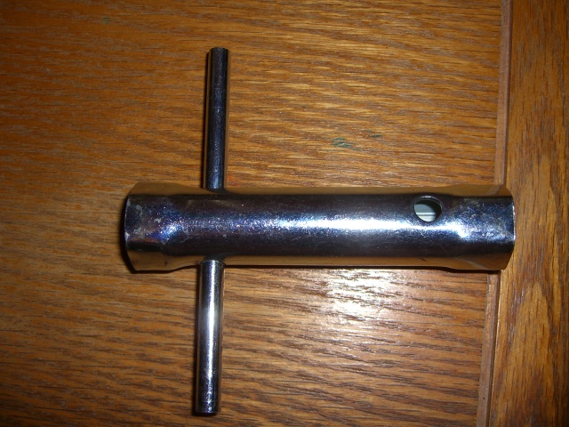

Guest azccj Posted June 19, 2006 Posted June 19, 2006 My underseat factory tool kit came with the tool to remove the oil filter access cover. It's on the oppisite side of the spark plug wrench it's a perfect fit and works great. Mine is a 2003 so I don't know if they changed something for that year. I'm glad I looked at the tool kit before I bought or fabrcated the tool. I decided not to use the regular MG filter, not because it cost $18.00 from the dealer but because I couldn't find a wrench to remove it. I got the Walmart filter and then bought a steel filter wrench from checker which worked perfectly.

Lawrence Posted October 12, 2011 Posted October 12, 2011 I didn't get a tool when I purchased my V11 Sport and I don't have easy access to a welder so I used a bolt and nuts with 27 mm heads in the configuration shown in the pics. Lock washer between the nuts prevents nut slippage (I hate when that happens!!)... Cost me $7.00 at Ace hardware. Works great!
