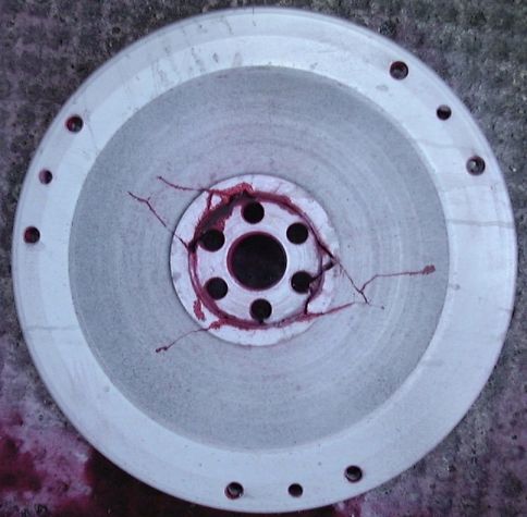

belfastguzzi Posted May 4, 2004 Posted May 4, 2004 Having just covered 1000 kms on my Scura (#580) the future doesn't seem too bright, unfortunately I suppose we'll all now be listening out for any increase/change of noise from the gearbox direction on these bikes, but if there is a definite problem with the clutch, surely there would be more horror stories by now? I recently passed the 1,000 mile mark. No problems with idle or stopping in traffic. Do you have tighter emissions controls in Denmark and tighter valve/rocker settings as a result? This does seem to be a regular complaint with the American set-up, which is cured by going to the more 'normal' wider gaps or even wider Raceco settings. It would be a good starting point anyway.
Paul Minnaert Posted May 4, 2004 Posted May 4, 2004 if there is a definite problem with the clutch, surely there would be more horror stories by now? there are 800 scura's? I know of tree with problems, is almost 0.5 %, but I'm shure I don't know all problems there are.
Guest John T Posted May 4, 2004 Posted May 4, 2004 Don't forget the 600 Rosso Mandellos and how many Tennis are out there?. Plenty of single plate clutch Guzzis around. (spine frame that is) Also, was the flywheel ever taken off these troubled bikes? I would think not using a torque wrench on the aluminum flywheel would be asking for trouble. impact guns are used way too much by poor wrenches.
Paul Minnaert Posted May 4, 2004 Posted May 4, 2004 John, maybe the rosso's clutch is a bit different? I think I heard the scura's clutch is improved
Guest John T Posted May 4, 2004 Posted May 4, 2004 If that's improved, I'll stick with my crappy old one!!! Almost 10.000 hard miles and not exploded yet!! (oh boy am I tempting fate or what) (and I don't think they are different)
roberto Posted May 20, 2004 Author Posted May 20, 2004 Well I finally got round to checking the flywheel further. You'll see by the photo that it wasn't going to be long before the cracks propagated to the rim
