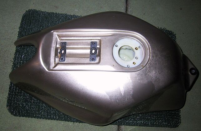

al_roethlisberger Posted May 4, 2004 Posted May 4, 2004 Just to add to that, sometimes it easier to remove the pad with the fuel cap assembly removed first. That "ring" of rubber around the filler is tough, but still fairly thin... you woouldn't want to rip it <_> Not a very good photo, but you get the idea:

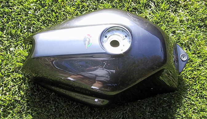

al_roethlisberger Posted May 5, 2004 Posted May 5, 2004 I think the 02 Tenni, Scura, and *maybe* the 01 Rosso Mandello?? .... have the CF tank pad replacement CF panel. On those models, I believe the CF panel uses 4 bolts to bolt into the threaded inserts that the brackets in the photo above attach to on 2002 and earlier tanks. But, the 03 Rosso Corsa, or other late model "limited editions", certainly don't have the CF tank panel, as beginning in 2003 the tanks no long have a "pad" on top, and were redesigned to accomodate the internal fuel-pump. These newer tanks are actually a bit longer at the nose, and now have a solid, taller, and narrower top, festooned with a contrasting color decal stripe where the old "pad" used to be. al This is a 2003+ tank:
