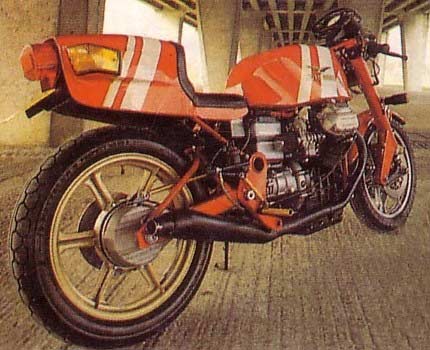

Admin Jaap Posted May 6, 2004 Posted May 6, 2004 Keith Breeden asked me to post this picture. Keith, could you comment the picture yourself?
Baldini Posted May 6, 2004 Author Posted May 6, 2004 Thanks Jaap. That's the Foale framed Guzzi done for a bloke at Motomecca in UK. Recognise it?
Guest Jeff Kelland Posted May 6, 2004 Posted May 6, 2004 Hmmmmmm, not like me to add fuel to the fire, but.... the frame here looks suprisingly like a mid 60's Harley Davidson / Aermacci, sprint / road racer......, In engineering terms, adaptation and refinement.
Baldini Posted May 6, 2004 Author Posted May 6, 2004 Well... I'll go check in the Ladybird Book Of Motorcycles ...but I fear you may be right...weren't they good lookin bike tho...
