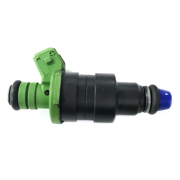

LaGrasta Posted August 16, 2022 Posted August 16, 2022 https://www.ebay.com/itm/143301245158 I haven't any connection to these, only just found replacements at a good price and wanted to share. These are sourced from AliXpress as further research revealed.

paulnaz Posted August 19, 2022 Posted August 19, 2022 The injectors your looking for have an industry part # IW 031, These are used on Maserati's, Lamborghini's, Ducati's and Moto Guzzi. Probably Lancia, Fiat and a few others. They are made by Weber Marelli and are available through most automotive supply houses. Avoid the Chineseum Paul B 5 2

Pressureangle Posted December 3, 2022 Posted December 3, 2022 On 8/19/2022 at 3:06 PM, paulnaz said: The injectors your looking for have an industry part # IW 031, These are used on Maserati's, Lamborghini's, Ducati's and Moto Guzzi. Probably Lancia, Fiat and a few others. They are made by Weber Marelli and are available through most automotive supply houses. Avoid the Chineseum Paul B Expand Note on my report that they show my injectors as IW 091. I called and they said they read that number from the injector body; it could be a typo but he's asked that I send a picture to verify when they arrive, for clarification. The flow numbers on the report align with the IW-031 published figures and I can't find reference to any IW-091. Stay tuned for academic, incidental drama. 3 1
Pressureangle Posted December 6, 2022 Posted December 6, 2022 Definitely IW-031. Now to the refit! 2 1
