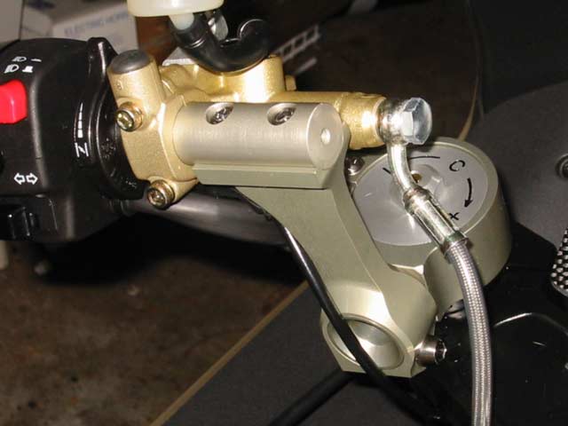

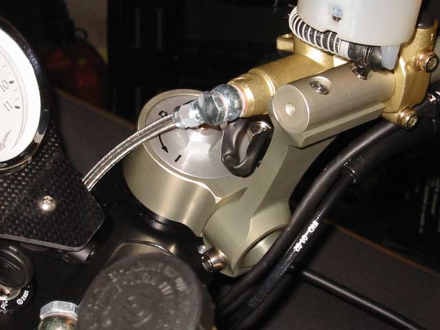

Guest bshpilot Posted May 9, 2004 Posted May 9, 2004 FWIW i installed a pair of Two Brothers Racing Clip On's the other day... Initially I had the clip-ons on TOP (like the OEM bars) but the OEM brake lines are too short. I installed the TBR Bars under the top clamp and they fit fine... you would be get the MOST (adjustment) if they were mounted on ON TOP of the top most triple clamp. I will be ordering new (longer) sep. / individual brake lines so that i can move the bars to the top. every thing fits very nicely & the build quality is 1st Class !

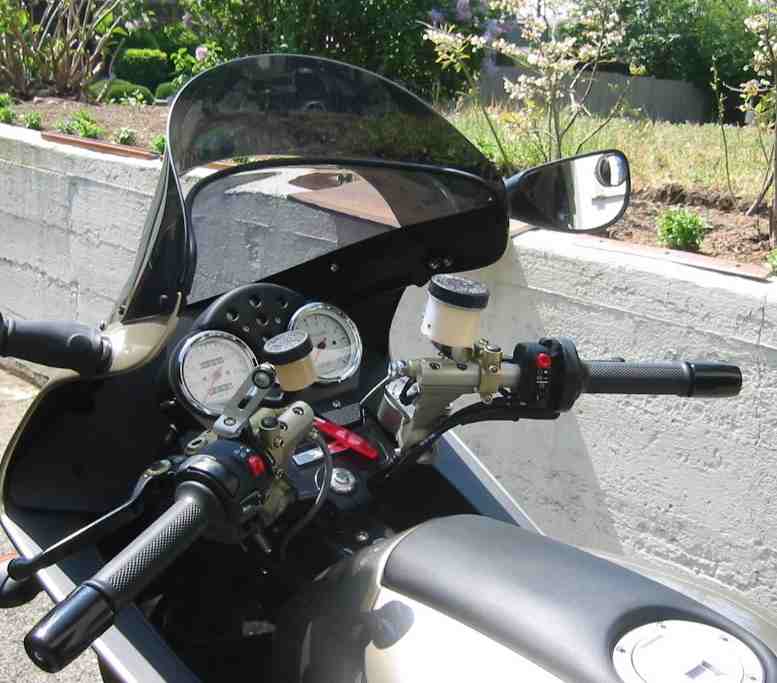

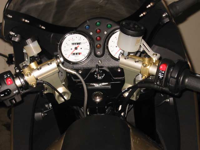

Guest dkgross Posted May 10, 2004 Posted May 10, 2004 yup. Only thing I don't like is my Clutch line..one of these days I'll get a longer one made and reroute it..
Guest dkgross Posted May 10, 2004 Posted May 10, 2004 and.... the thing I like the most is that they're pretty adjustible..can be swung 'outward', as well as tilted up or down. I tweak them once in a while, and have finally found a position I like. and, I love the color. matches my bike
al_roethlisberger Posted May 10, 2004 Posted May 10, 2004 Thanks Dave! Ahh, so you were able to mount them above the triples... eeeenteresting I didn't realize that. ...did you have to drop the triples a bit to do so? It seems like there isn't enough of the fork crown normally protruding above the triples as delivered stock otherwise ...or maybe it's just an optical illusion Another interesting observation is that you must have a later model 2002, as your controls are the late 2002/2003 variants. I picked up a set of 2003 switchgear on eBay a month ago, and the right hand switches will swap out evenly with no modification, but the left uses a different harness I believe. It will plug-in, but it looks like the wires are all rearranged in the connector Just something "good to know" in case you ever need new controls/switchgear. al

Guest bshpilot Posted May 10, 2004 Posted May 10, 2004 ...did you have to drop the triples a bit to do so? It seems like there isn't enough of the fork crown normally protruding above the triples as delivered stock otherwise ...or maybe it's just an optical illusion you are correct the top clamp needs to be dropped...but not much over what the OE clip-ons require...i measured about 5mm diff (more drop). where can i order the proper length brake & clutch lines ? (or do you know the "measured/length") w/ the TBR clip-ons theres not a TON of reason/gain when theyre mounted UNDER the top clamp...certainly theres more adjustment than stock but height is about the same as stock (w/ a 2.5inch riser)
Guest dkgross Posted May 10, 2004 Posted May 10, 2004 you may want to call Aaron at Moto International and ask him to ask Jason what he did regarding my cables. I need to take one more photo of the front brake line for ya'll tonight. I know he changed that out as well.

Guest bshpilot Posted May 10, 2004 Posted May 10, 2004 you may want to call Aaron at Moto International and ask him to ask Jason what he did regarding my cables. I need to take one more photo of the front brake line for ya'll tonight. I know he changed that out as well. Dave could you do us a favor ??? take some string and measure from each brake caliper (following/tracing along the brakeline) up to the brake master cylinder.... they brake lines wont be the same length so it would be critical to measure each line... then would you be so kind to share the length of each line w/ me PLEASE...
al_roethlisberger Posted May 10, 2004 Posted May 10, 2004 I too would like to know the length of the clutch, and both front brake lines when adding risers. I was given a set of risers, similar in execution to the MPH units, but I'll need new lines. So it would be great to know how long each of the three lines has to be. al
Guest dkgross Posted May 10, 2004 Posted May 10, 2004 sure....I won't be able to get to it until I get home tonight tho.. I think I have some string....
