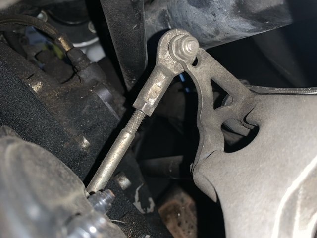

dowieze Posted September 8, 2022 Author Posted September 8, 2022 I think I do not have to lenghten the shift lever arm. It seems already assembled on the highest position.
KINDOY2 Posted September 8, 2022 Posted September 8, 2022 What he said... "The single biggest improvement you can make to the shift action of your V11 is to lengthen the shift lever arm and incorporate a neweye end mount hole 12mm ctr to ctr from the original upper hole." 1
docc Posted September 8, 2022 Posted September 8, 2022 6 hours ago, dowieze said: I think I do not have to lenghten the shift lever arm. It seems already assembled on the highest position. 56 minutes ago, KINDOY2 said: What he said... "The single biggest improvement you can make to the shift action of your V11 is to lengthen the shift lever arm and incorporate a neweye end mount hole 12mm ctr to ctr from the original upper hole." @KINDOY2 is correct. The highest position of the factory part is the lowest position of the improved part. Also, @dowieze, your connecting looks awfully long. Check that its length aligns the shift lever arm square to the gearbox lever arm . . . 1
