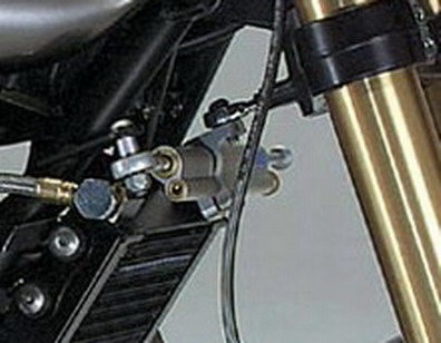

gh67 Posted March 7, 2005 Posted March 7, 2005 I recently picked up a new Ohlins SD1100 (90mm stroke) steering damper for my v11 Naked. Everything that I've read says that it would be closest fit to the original 80mm Bitubo. Though it looks as thought the SD1100 does not have the "L" shaped bracket and won't bolt on the stock mounts cleanly (coming to this conclusion after an hour of trying to make it work). Here's a diagram of what my SD1100 looks like. Here is the Cafe Ohlins damper....does anyone know what model it is? I know that the Ducati SD120 (68 mm stroke) has a similar mount but I don't believe going shorter is a good idea. Any help is appreciated.
al_roethlisberger Posted March 7, 2005 Author Posted March 7, 2005 With the naked bikes, just about any "reasonably close to OEM" length damper will work. I don't know the model # of the Ohlins used on the Cafe Sport, etc.... but you can find used Ohlins on eBay all the time for relatively cheap. So find one that is the right length, and it should bolt right on With the faired bikes(LeMans), clearances between the bottom of the fairing bits, and damper, only allow for a single tube solution, not stacked "wide" tube version like the Ohlins. al
gthyni Posted March 7, 2005 Posted March 7, 2005 Though it looks as thought the SD1100 does not have the "L" shaped bracket and won't bolt on the stock mounts cleanly (coming to this conclusion after an hour of trying to make it work). Just get a longer bolt and some appropriate washers and you will get good steady mount between the lower joke and the middle of the damper. Only problem is that it gets very close to the oil cooler.
JuhaV Posted March 7, 2005 Posted March 7, 2005 Hi, In my Sport 1100i I have a LSL damper from Stein Dinse : Artikelnummer 300042301 Lenkungsdämpfer LSL Alu L: 290mm/Hub:70 : 124,12 € It seems to work well and it is reasonably priced compared to Bitubo or Öhlins products. This one should fit also a V11. I did make some kind of a combination of the orginal Bitubo attachment parts together with those that came with the LSL. That was however only a 5 minute job. br, JuhaV
gh67 Posted March 7, 2005 Posted March 7, 2005 Just get a longer bolt and some appropriate washers and you will get good steadymount between the lower joke and the middle of the damper. Only problem is that it gets very close to the oil cooler. 45432[/snapback] Do have a picture of this configuration? It would seem that a longer bolt would even further reduce the clearance to the oil cooler. The Ohlins SD 120 comes with the Ducati mount bracket that looks very similar (maybe the same) to that of the v11 Cafe version (ie.. "L" shape). It has a 68mm stroke vs the stock 80mm on the Bitubo, does any one see this as a problem? Would it reduce the distance that my steering travels? I went with the SD110 because the 90mm size...but the bracket is for a universal install and Ohlins USA wants $143 for the SD120 L bracket.
