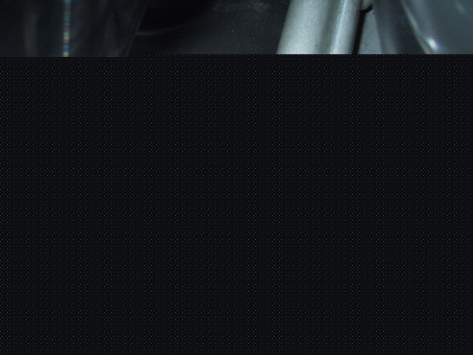

al_roethlisberger Posted March 11, 2005 Author Share Posted March 11, 2005 I have the universal ohlins mounted on my LeMans. no problem. Think outside the box. I'd post a photo but I don't think I can get a decent picture.80 or 90 mm stroke...can't remember which andy 45888[/snapback] Andy, Can you provide a good photo or two of the install, and model # of the Ohlins used? Mike Stewart and I went through several models of Ohlins, including the Aprilia OEM unit that has the mount integrated to the body, and were unable to get it to clear the "air-dam" under the fairing(that goes around the fork legs) due to the Ohlins twin-tube(wide) design. Thanks al Link to comment Share on other sites More sharing options...

andy york Posted March 13, 2005 Share Posted March 13, 2005 Ohlins on a LeMans...I remember now I pressed out the sperical bearing that came stock in the mount. Then I machined a piece of aluminium the length I needed to press fit in its place( the bearing) I think it was the 80 mm stroke universal andy Link to comment Share on other sites More sharing options...
andy york Posted March 13, 2005 Share Posted March 13, 2005 sorry heres the pic andy Link to comment Share on other sites More sharing options...
andy york Posted March 13, 2005 Share Posted March 13, 2005 ok ....so i don't do my best on sat night .... ...the other pic andy Link to comment Share on other sites More sharing options...
