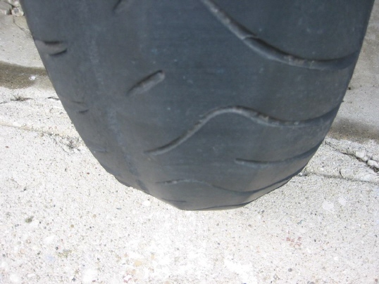

twhitaker Posted May 18, 2004 Author Posted May 18, 2004 Here is the main reason I'm getting a new tire. This Michelin Macadam 100x has 13,000 miles on it. I found out the Michelin Pilot Road is the replacement for it. Hope to get somewhere near as many miles from the new tire. The tread wear is odd until I thought about. On my route home from work there is a long sweeping left hand turn that goes over a bridge. This overpass is laid with very rough concrete. Kind of acts like a rough file on the side of my eraser.
badmotogoozer Posted May 18, 2004 Posted May 18, 2004 there's plenty of tire left - 2 seasons at least! Love that profile Rj
badmotogoozer Posted May 18, 2004 Posted May 18, 2004 Wait... doesn't that long left sweeper become a long right sweeper on the way back? Hmmmm are you riding harder on the way home, or on the way to work? Which one are you dilly dawdling to? Or should I just shut up and mind my own buisness... Rj
twhitaker Posted May 18, 2004 Author Posted May 18, 2004 This sweeper is where a highway merges with an interstate. Got left hand sweepers both directions. We call this area "Malfunction Junction." Come to think of it there are 2 more left handers at the other end of my interstate race course. For those of you from the midwest it's I-75 in downtown Dayton OH.
