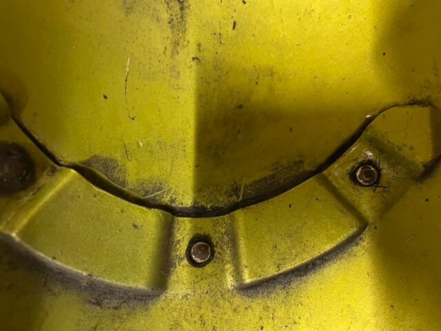

Guzzimax Posted October 13, 2022 Posted October 13, 2022 Greenie’s now off the road for various autumnal jobs. Front fender has a crack that needs repairing, and the I’ll get it repainted along with the belly pan and the side panels. However the very small screws that hold the 2 pcs of the fender together are corroded, and despite soaking them in plus gas release fluid, gripping with long nosed pliers, the nuts just spin and I can’t release the screws. I’m unwilling to try grinding them off with a mini grinder in case of damaging the plastic im sure this is a very common problem, does anyone have suggestions about how to grip the small round threaded ‘nuts’ ? 1
Tomchri Posted October 13, 2022 Posted October 13, 2022 Looks like 1 from the picture is doable with a wise grip. Can't see from picture if the other 2 are above the plastic. Cheers Tom. 2
docc Posted October 13, 2022 Posted October 13, 2022 The "small round threaded nuts" are embedded in the rubber causing expansion to capture the fender part when tightened. So, rather than try to put locking pliers on the metal 'nut', you may do better to grasp the entire rubber/metal unit (I'm sure those fasteners have a name . . . ) Obviously, they may need replacement if forced apart in this way. 1
docc Posted October 13, 2022 Posted October 13, 2022 Okay, how about "rubber well nut, expanding" or "insulating rivet nut" . . . https://www.mcmaster.com/rubber-well-nuts/ 1

Tomchri Posted October 14, 2022 Posted October 14, 2022 Well, your the docc, but I coudn't do it. One old and a new layer of paint made it to tight. Tight is nice, but Cheers Tom. 1
Scud Posted October 14, 2022 Posted October 14, 2022 Cut the rubber away from the underside with a small knife. After that, they should pop right out the top. 2
docc Posted October 14, 2022 Posted October 14, 2022 9 minutes ago, Scud said: Cut the rubber away from the underside with a small knife. After that, they should pop right out the top. Thinking out of the box again, @Scud !
mikev Posted October 14, 2022 Posted October 14, 2022 Maybe a Dremel tool with a diamond blade could cut with enough precision to remove seized bits without damaging plastic? In the past I've cut seized bolts top down (bisecting nut in half) vs horizontally with good results. 1
Tomchri Posted October 14, 2022 Posted October 14, 2022 Thinking out loud here, lf you do that, l bet some of the brass round nut will be left, not reachable. Like Scud said, or l woud try first with the wise grip firmly fastened around the rubber bushing. IPA time here. Cheers Tom.
