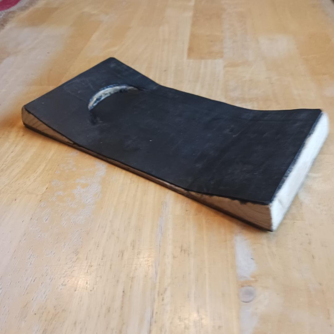

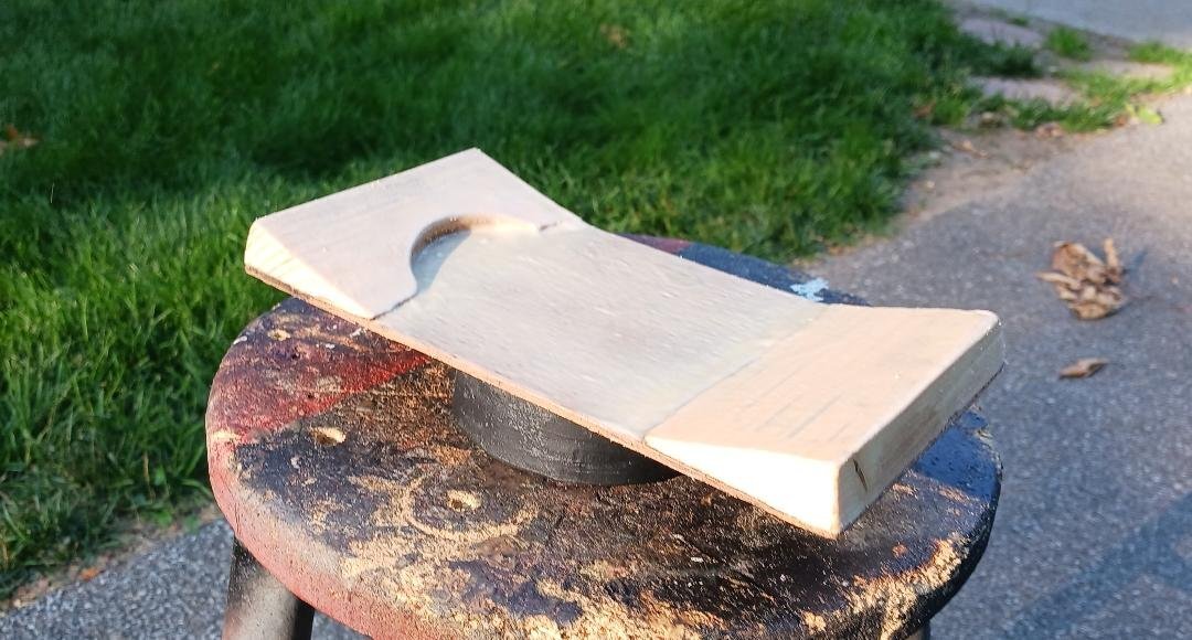

Skip Posted October 17, 2022 Posted October 17, 2022 I made a cradle for under the oil pan which more than doubles the the stability, and a strap to the ceiling. 4

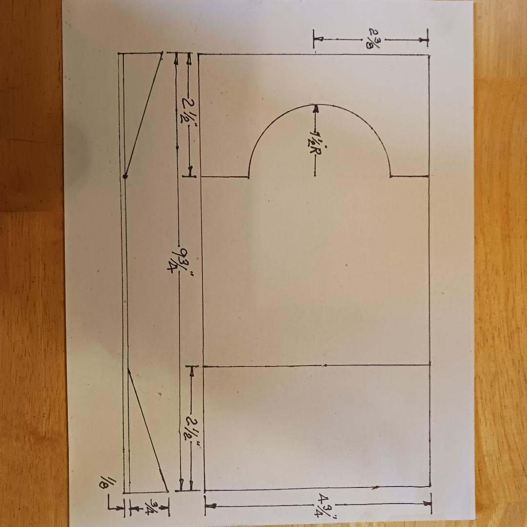

docc Posted April 27, 2023 Posted April 27, 2023 On 10/17/2022 at 11:43 AM, Skip said: I made a cradle for under the oil pan which more than doubles the the stability, and a strap to the ceiling. I love this concept, @Skip! How did you derive those dimensions and angles? Does the "half moon" cut-out index on the oil filter access cover or is it simply a relief cut for the access cover? 1
Skip Posted May 2, 2023 Posted May 2, 2023 On 4/26/2023 at 9:24 PM, docc said: I love this concept, @Skip! How did you derive those dimensions and angles? Does the "half moon" cut-out index on the oil filter access cover or is it simply a relief cut for the access cover? Hey Doc, Been really busy, but thanks. The cradle can be rotated for either access depending where you want your balance point. Greatly increases stability. Smiles, SKIP 3 1
Speedfrog Posted May 2, 2023 Posted May 2, 2023 43 minutes ago, docc said: A legit two view dimensioned drawing! Hand drawn!! 1
