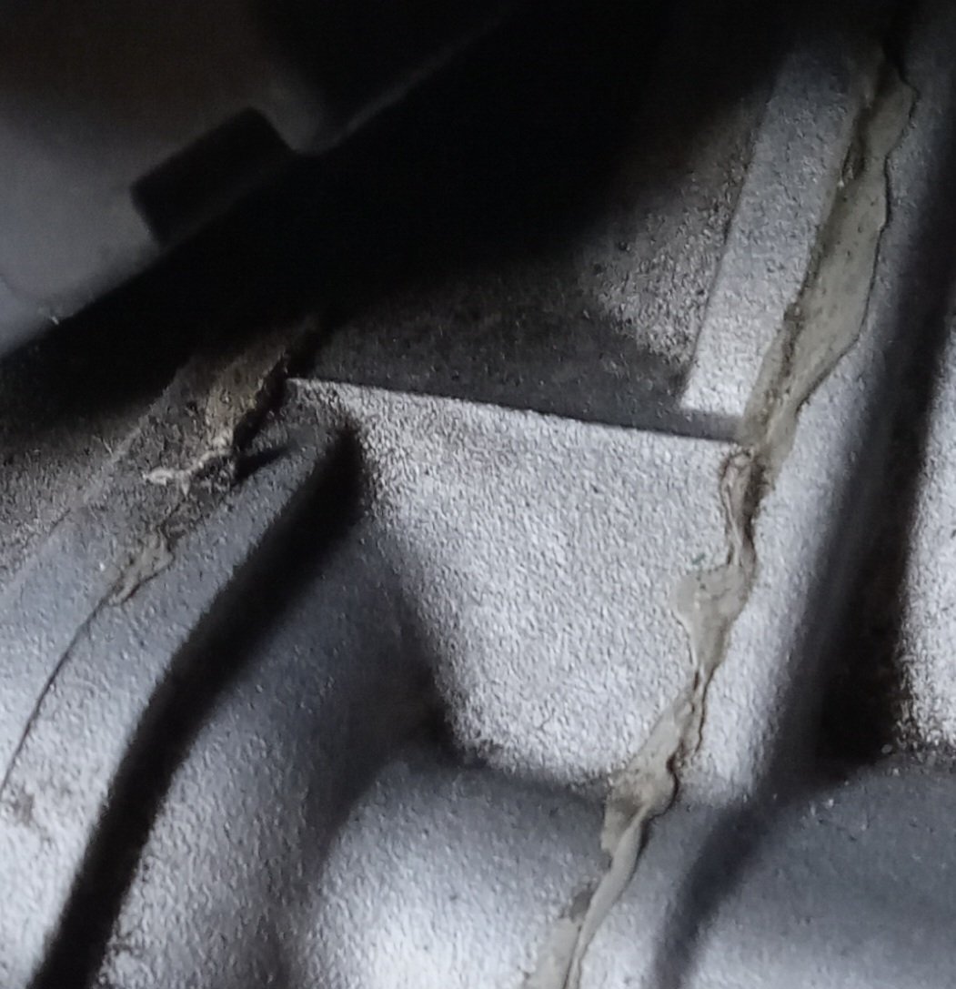

OuijiVeck Posted March 19, 2024 Posted March 19, 2024 Thanks docc. Not the news I was hoping for but always good to get your input...what the heck do I do? Try to get the kit, look for a tyranny or wait for it to blow up in 6th at 80mph infront of a trailer truck. ? Did you go thru this. ?
OuijiVeck Posted March 19, 2024 Posted March 19, 2024 Presently clinging onto signs the work was done .... 1

audiomick Posted March 19, 2024 Posted March 19, 2024 7 hours ago, OuijiVeck said: ...signs the work was done .... It seems pretty obvious that someone has had that apart for whatever reason, but it doesn't look like the work of a "professional" workshop to me. Maybe I'm too critical, though. 1
OuijiVeck Posted March 20, 2024 Posted March 20, 2024 Ya...can't understand leaving it gobbed like that. Even I would have scraped off the excess.... 🤣 maybe they cracked it open, smeared goo in the crack and sealed it back up....?? Ain't leaking now... Called Seacoast Sports who had a record of servicing it 4 times but never saw a recall or see one now on that vin. ... Going to change the oolong tea clutch juice. See if it still SNICKS. Was waiting to do that when I did my shift spring... I guess I'm doing that sooner than latter....pull my panties up and get at it. I was NOT looking for a project or death trap. Any tales of warning signs besides doccs false neutrals? 1
