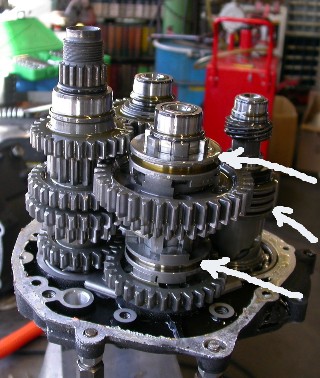

These are the nefarious recall parts:
Otherwise, as @pete roper said, "Perhaps the nuts on the end of the shafts have loosened/spun off? That was the issue with the last V11 box I was buggering about with . "
